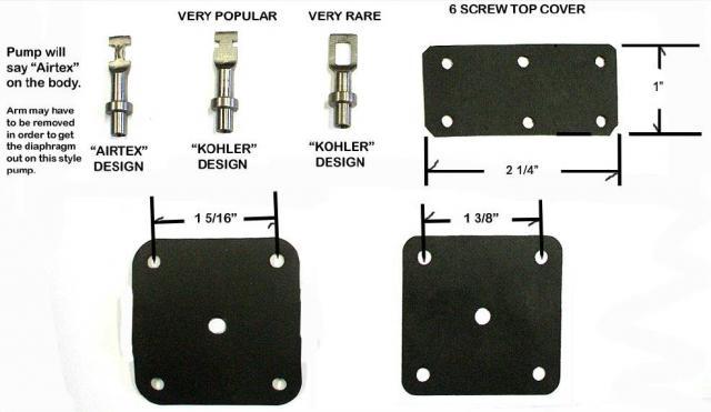

wheeledhorseman 579 #11 Posted June 24, 2013 (edited) Richard, I'm very interested as it's only a matter of time before I'll end up needing to rebuild the pumps on my Kohlers. Did your kit(s) come from 'Then And Now Automotive' as advertised on maritimedragracing.com ? Curious in that they show two different diaphragms. I assume you received the larger when you needed the smaller one or were neither of these sizes correct? Andy Edited June 24, 2013 by wheeledhorseman Share this post Link to post Share on other sites
Anglo Traction 761 #12 Posted June 24, 2013 Hi Andy, Never/can't see that image on their site, but yes, I dealt with that Company and the Kit version was AC-4S for my Pump versions. There was no option for the hole PCD/spacing size. I know several people had to re- punch the holes in the Diaphragm to fit their Pumps and I had no issue with that requirement. To avoid hijacking this Thread (sorry), I'm happy to run one in Euro Section to see if a kit or at least the Diaphragm part can be produced in UK. Share this post Link to post Share on other sites
