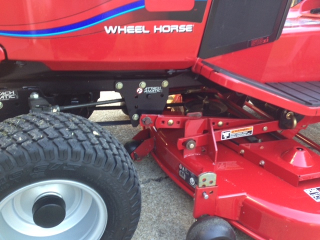

RMCIII 838 #9 Posted June 19, 2013 I am sure others have very clean decks also, but here is a deck, that is 18 years old. Has been on this tractor since 1998. So, if you look to keep a clean, long lasting deck, wash, wax, polish and it may last 40 years. Share this post Link to post Share on other sites
