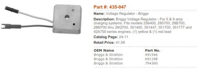

gwest_ca-(File Mod) 12,086 #21 Posted March 8, 2014 Why couldn't one of these be added? Garry Share this post Link to post Share on other sites
Save Old Iron 1,573 #22 Posted March 9, 2014 (edited) Garry, that may just work. I'm not sure if that particular box has an internal diode along with the regulator. If so, you may have to remove the diode in the wiring from the WH stator. Regardless, at $40 + shipping, that would be about half the price of making the 15 amp conversion. I have resolved the overcharging in a 211-5 by inserting 2 extra diodes. Others have not had luck with the same fix. I believe the variability of the AC voltage from stator to stator makes the "extra diode" trick an uncertainty. Higher voltage stators would require more diodes and this quickly becomes a ugly hack with too many diodes needed. Edited March 9, 2014 by Save Old Iron 1 Share this post Link to post Share on other sites
gwest_ca-(File Mod) 12,086 #23 Posted March 9, 2014 I have one of these on a motor that I do not use the electric start on. I don't have a WH with a 3 amp charging system to try it on. Is there a way I can check to see if it has an internal diode? The box I have is cast aluminum so suspect it is a heat sink. Garry Share this post Link to post Share on other sites
Save Old Iron 1,573 #24 Posted March 9, 2014 . Is there a way I can check to see if it has an internal diode? Probably check the wiring diagram for the engines this is used on. If the diagram lists a diode or shows a diode in the harness, then I would think this item is just a voltage regulator. If no diode is seen in the harness, this item would most likely be a rectifier / regulator. Otherwise, electronics test equipment would be needed to put an AC signal into the yellow lead and see what comes out of the Red lead. 1 Share this post Link to post Share on other sites
gwest_ca-(File Mod) 12,086 #25 Posted March 11, 2014 I suspect this regulator has an internal diode as there is no other in the parts lists for this 190407-3125 8hp B&S engine that I can see. This B&S chart has the regulator identified as H and this application is 5 amp. They list a diode OR regulator in the chart 691955 is a diode 691188 replaced by 794360 is the regulator They are looking for 28 volts AC minimum at the stator. Need to look and see if I have an AC transformer to test this. Thoughts? Garry Share this post Link to post Share on other sites
