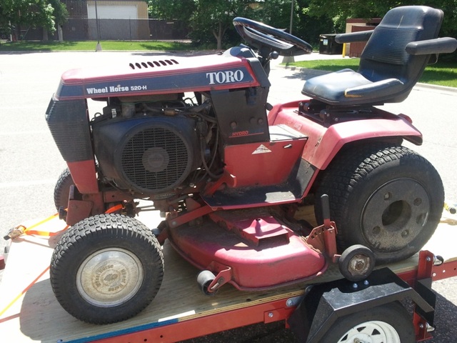

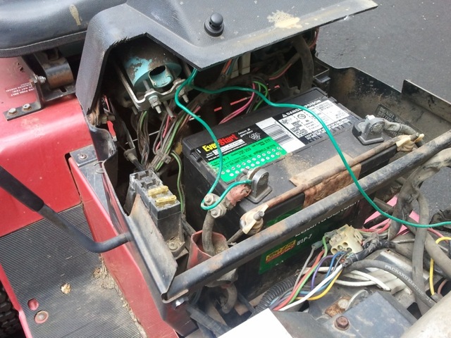

Catt 13 #1 Posted June 17, 2013 I made a dumb move today and did a Wheel Horse search on Craigslist. A 520H was listed for $350 and I'm not sure it's ever been stored inside. Plenty of pitted rust and dirt. There are many mysteries with the tractor, like the hood and wiring harness for starters. Much of the wiring is disconnected and a green wire is used to start the engine by connecting it to the plus terminal to engage the starter. The hood has a brace that's been bent to fit over the battery (Not sure why). The compression seems like it should be OK and it runs good sometimes. Other times it's like it is running too rich and has a surging issue. If I add a little choke the surging gets significantly worse. I have mixed feelings as I don't know what I'll do with it yet. Maybe next year I'll rebuild it, but not this year. 1 Share this post Link to post Share on other sites

Sparky-(Admin) 23,810 #5 Posted June 17, 2013 You did fine at $350. Those rear wheel weights are worth $75-$125, the 48" deck (if its good and it looks good to me from here) is a $300 item. Probably just needs real good carb cleaning to get the Onan to run smooth. The only way you could loose money would be to rebuild the motor, then you would have more into it than you could get out of it in my opinion. Mike............ Share this post Link to post Share on other sites

47JDG 65 #8 Posted June 17, 2013 Yes as Jake said, you did very good for that price. It has certainly spent some time outside but it has not been outside its whole life or it would look far worse indeed (I think it looks fine as it is once you straighten out your wiring situation). I would have paid $350 for that tractor no question. Don't feel like you need to completely over haul it and make it look new again. It may only need a few simple repairs and then be fine for years of service. I say enjoy it! Share this post Link to post Share on other sites
546cowboy 302 #9 Posted June 17, 2013 I agree with the above and there is no way I would pass up a 520 for $350. Most people are very inept at electrical and instead of fixing a problem they eliminate the wires and as long as it runs, so what? Most of the guages you can do without if you don't want to fix them. From the picture it looks like a 1990. Great find. Share this post Link to post Share on other sites
Wheel Horse Kid 105 #10 Posted June 17, 2013 That was not a dumb move at all! A 520H that is running with deck and wheel weights/hub caps for $350 is a very good deal in my opinion. 520's are awesome tractors (I also have a 1990 520H)!! Good Luck with it! Share this post Link to post Share on other sites
Catt 13 #11 Posted June 18, 2013 There was a switch on top of the dash that somebody installed for starting the engine, but the switch was bad. I replaced the switch and connected the green wire. It now starts with a push of the button. The forward/reverse speed was way off. It was much faster in reverse than forward. I made an adjustment to the cam below the seat on the hydro. It's now much faster in forward than reverse and seems about right. Next I'll need to adjust the neutral lever location and brake neutral position. I'm not sure how to do that yet. I adjusted the choke because it wasn't opening completely and now the engine seems to run fine. I mowed my grass with it and am pretty amazed. It's far from pretty, but it worked good. Share this post Link to post Share on other sites

Catt 13 #17 Posted June 18, 2013 Well I just found the number one item on the list to repair. The battery isn't being charged which I'm guessing is the wiring nightmare. I have a couple wiring diagrams, but will certainly take suggestions. I need to check the fuses first... Share this post Link to post Share on other sites
Catt 13 #18 Posted June 18, 2013 On top of the Onan engine is a three terminal device that looks like a voltage regulator to me. It has three white wires connected to it. I think the center terminal is the output and should be what charges the battery. Is this correct? Share this post Link to post Share on other sites
Catt 13 #19 Posted June 18, 2013 Well that looks correct. So with a little testing is seems to voltage regulator is working fine. Now back to the wiring nightmare. Somebody cut, taped and spliced a lot of wires. Many others are disconnected. Share this post Link to post Share on other sites
6wheeler 670 #20 Posted June 18, 2013 Usually its the 30 amp fuse (the one closest to the dash tower) that is not connecting. Check it out. Wiggle it with the tractor running and see if the voltmeter jumps. 1 Share this post Link to post Share on other sites
Catt 13 #21 Posted June 18, 2013 Thanks for the 30 amp fuse suggestion. It's one of the many things missing (along with the wires to the fuse). Share this post Link to post Share on other sites
Catt 13 #22 Posted June 19, 2013 I repaired much of the wiring, replaced the fuses and now the battery is charging properly. Everything works on the dash too. Even the hour meter works and I'm sure it hadn't worked in years since it reads 255 hours. I removed the rear fender, a few other panels and power washed off years of dirt and grime. Not sure how many animals had been living in this thing, but it was filthy. I had to use a shovel to clean my driveway after the power wash. I mowed my lawn today and to my surprise it worked fantastic. I still need to work on the hydro forward/reverse speed adjustment. Share this post Link to post Share on other sites
