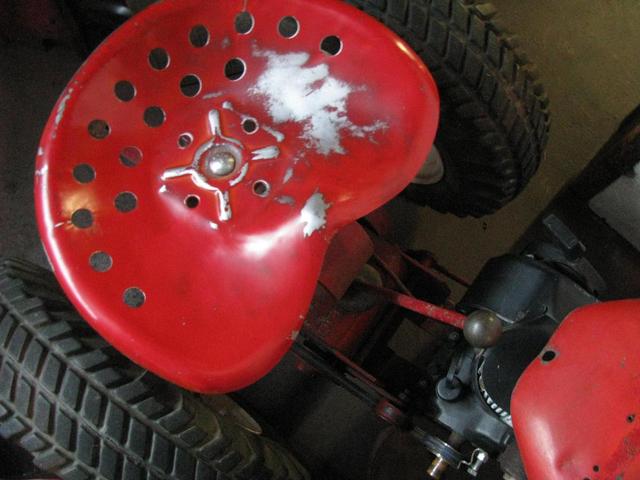

AMC RULES 37,259 #5 Posted June 16, 2013 (edited) From my experience Jesse, there are many different ways to successfully remove serious rust... if you have success with the steel wool idea, share with us some tips on how you did it. Edited June 16, 2013 by amcrules00 Share this post Link to post Share on other sites
