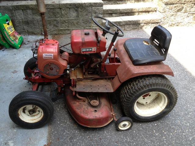

jf31276 0 #1 Posted June 12, 2013 Hi everyone just wanted to say hello just got my first wheel horse it is a 1970 raider 10. was wondering if anyone was from south jersey and could help with getting my horse up and running it will start with starting fluid but wont stay running. i took apart the carb and cleaned it waiting on a carb rebuild kit Share this post Link to post Share on other sites
chazm 413 #2 Posted June 12, 2013 to R/S , I know we have some jersey members,they'll be along shortly. Sounds like you started in the right place to rebuild the carb. ifs been sitting for awhile ,let the card soak in cleaner , blow out with air. Replace gas filter & fuel lines as well & see what happens after that chasm Share this post Link to post Share on other sites
raider10-8 9 #3 Posted June 12, 2013 if you put the carb rebuild kit in and it dosent do much. change or clean the spark plug. other wise there not much to do but what he said^. Share this post Link to post Share on other sites

jf31276 0 #7 Posted June 12, 2013 well after a little more tinkering got it started and running but it was really ruff. need to get new throttle cable also Share this post Link to post Share on other sites
Jeff-C175 7,207 #8 Posted June 12, 2013 How far south? Does 'cmch' mean something like Cape May County? ...general area is fine if you don't want to 'advertise' to the general public. Does the machine have a fuel filter in line? Change that. You also may have deteriorated rubber fuel lines... If there was fuel in the tank, dump it and start fresh. You've changed the oil, yes? Was what came out 'normal' looking? or like 'chocolate milk' ? If you got chocolate milk it means there was some water in the oil. Happens when stored outdoors. You may need to change it a couple times before you get it all out. Did you get a hood with the machine? Share this post Link to post Share on other sites
jf31276 0 #9 Posted June 12, 2013 Yes I do have hood just off so I could get to the carb easier The guy I got it from said he had it serviced and it was running three years ago. I did check the oil and it looked good. I am in Cape May Courthouse New Jersey which is exit 10 gsp Share this post Link to post Share on other sites
Jeff-C175 7,207 #10 Posted June 12, 2013 That's a little far for me ... I'm up by 114 ... Tellya what though, get the carb kit, take your time and clean it out real good and see how it goes. Share this post Link to post Share on other sites
