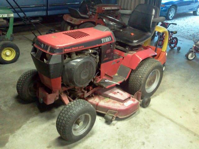

Dieselcowboy 211 #11 Posted June 10, 2013 Here is the pic. It needs some work but what doesn't that is 23 years old. Should be plenty one topics on the forum to help me fix the problems it has. Engine fires are runs perfectly though. Thats a good start. Most of what I have is going to be electrical. 1 Share this post Link to post Share on other sites

Sparky-(Admin) 23,809 #14 Posted June 10, 2013 The first thing I would do if I was the new owner of that tractor is take the engine tins off and totally clean every nook and cranny of grass clippings and all buildup of crud. Pretty much clean the whole block and cooling fins to be sure there are no cooling issues which seems to be what causes the most headaches for ONAN owners. Maybe even vent the beltguard by the rear cylinder. Good luck with her! Mike........ Share this post Link to post Share on other sites
cheesegrader 434 #15 Posted June 11, 2013 I agree with Sparky. Clean the holy crap out of it! Change all the fluids and filters, consider synthetic oil in the hydro, especially if you use it in the cold. Clean the fuse box and replace the fuses. Amazing how much grief debris in the fuse block has caused me. Grease everything. Put anti-seize on the hitch pin. Put a spinner kob at 8 o'clock on the wheel and..... DRIVE IT LIKE YOU STOLE IT!!!!!!!! THE POWER! THE POWER!!! AH HA HA HA HA HAAAAAAA!!!! (and get rid of the stupid screws holding the covers over the rockshaft. You will curse every time you strip one. Trust me. Mine are now stainless steel button head hex bolts) Share this post Link to post Share on other sites
cdsl810 181 #16 Posted June 11, 2013 I've got a 1990 520-H as well and love it. The only issue I have had is with the wiring. I ended up replacing the fuse block with weather tight individual fuse holders. And I applied dielectric grease to all 9 connections on the 9-way block. No more electrical issues. I considered changing out the steering to the gear reduction version, but haven't... It's actually easier to mow around obstacles with the standard steering rack. The only other design snafu besides the two main electrical complaints is the parking brake setup. Not a fan, mine is very finicky. Running synthetic oil in the hydro makes a difference. The 520 is a beast! Enjoy it. Share this post Link to post Share on other sites
Dieselcowboy 211 #17 Posted June 11, 2013 What weight of oil goes in the hydro? I am assuming it will be engine oil? Should I stick with a WH filter on that or Cross over to a Napa brand? I did clean everything out tonight with air and the pressure washer. Do have a few more questions for the experienced ones here. It will Not start off the key switch. It is not getting power to the solenoid wire at the starter. Any ideas here? Also I think my charging issue is the regulator. It has 40ac volts out of the stator and under 9-10 out of the B+ of the regulator. Am I on the right track? The brake pedal also wants to push the hydro handle forward. Must be an adjustment to it. It is very powerful and thirsty just as most have said here. Thirty is not good at $4.25 a gallon though! Anything worth having you have to pay for I guess. Share this post Link to post Share on other sites
