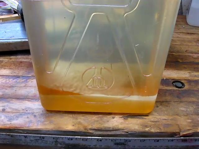

Save Old Iron 1,571 #45 Posted July 31, 2013 (edited) Guess I really did not need dye to observe the phase separation. I finally had the opportunity to experiment a bit with E10 and adding water. Experiment successful !! Click on the image to play the movie - yes, that is a layer of water + EtOH on the bottom of the container separated from the gasoline component on top. The container shows about 20% water and EtOH to 80% gasoline. That is pretty darn close to what you would expect. Edited July 31, 2013 by Save Old Iron 1 Share this post Link to post Share on other sites
Save Old Iron 1,571 #47 Posted July 31, 2013 Chem guys - can I calculate the lowered octane rating of the supernatant? If my intent would be to use the now ethanol free supernatant, I wonder how much Premium gas I would need to keep the octane above regular grade octane when I added the supernatant to a quantity of Premium grade E10. Share this post Link to post Share on other sites
wh500special 2,275 #48 Posted August 1, 2013 (edited) Fuel octane blends more or less linearly. If you blend half and half 91 octane and 87 octane you get 89 octane. Most gas stations only keep high test and regular in their tanks and then blend at the pump to whatever is supposed to be dispensed. I think Ethanol is about 103 octane. If the E10 you bought was labeled as 87 octane, the resultant gasoline phase is probably close to 85. Let X=octane of gasoline portion of the mixture (0.10)*(103)+(0.90)*(X)=87, solve for X. The logic to this calculation is: (volume fraction ethanol)*(octane of ethanol)+(volume fraction gasoline)*(octane of gasoline)=Octane of mixture I'd bet 85 octane is high enough to run a lawnmower engine without a lot of complaint until it gets hot. Then it might knock a bit. Steve Edited August 1, 2013 by wh500special Share this post Link to post Share on other sites
