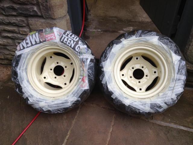

meadowfield 3,117 #152 Posted August 16, 2014 Did manage to get two of the wheels painted as well as a lot of other wheels... 3 Share this post Link to post Share on other sites
Sparky-(Admin) 26,144 #153 Posted August 16, 2014 Good color choice on the rims ! Mike...... Share this post Link to post Share on other sites

meadowfield 3,117 #157 Posted August 25, 2014 Good color choice on the rims ! Mike...... IH white Mike... Nice work Mark. I'd been following the thread on MoM. Great fabrication work. I'd love one of these, it looks brilliant. Must be a hoot to drive! Looking forward to that day The planning, setup and fabrication is simply awsome. Gonna be a really super nice tractor. Great job Mark. Thanks, I'm getting there Last bit of painting before my holiday, I can pretty well put the whole rear end together once it is painted. 1 Share this post Link to post Share on other sites

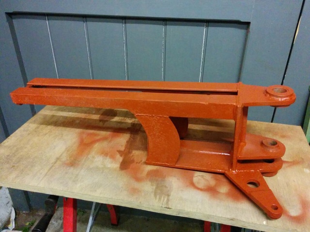

meadowfield 3,117 #161 Posted August 31, 2014 Managed to get some painting done Looks a lot better with some red on! 2 Share this post Link to post Share on other sites
