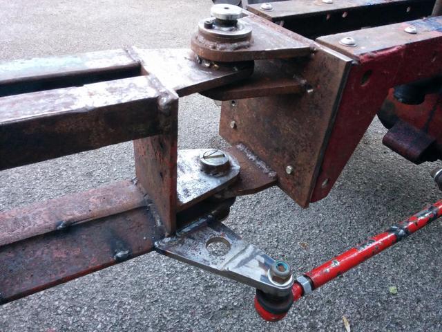

meadowfield 2,955 #126 Posted May 17, 2014 Small update, bendy now steers! 4 Share this post Link to post Share on other sites

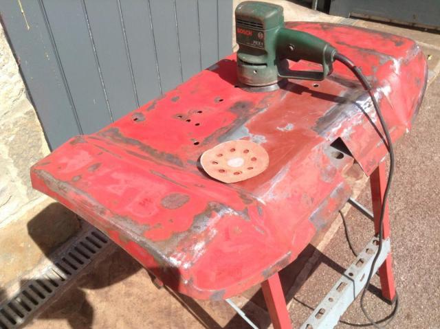

meadowfield 2,955 #128 Posted May 31, 2014 (edited) An overdue update... Thought I'd get in the action on fender repairs, by the time I welded up the holes in a c series fender, I thought it easier to weld up the very rusty raider fender. Here it is with most rust cut out and patched And with the last patch in place Time for a short video showing the final transmission arrangement and steering. http://youtu.be/S6zzlN8f1-0 And some pics with the body mounted and engine It was going to Newby, but now the GT is going there's no room... :( Edited May 31, 2014 by meadowfield 7 Share this post Link to post Share on other sites

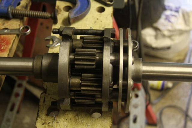

meadowfield 2,955 #141 Posted June 28, 2014 I've done a build thread, here's the final finished diff with locker. Just the selector to finish, it's a tight squeeze in there with only an inch to fit everything in. 1 Share this post Link to post Share on other sites
19richie66 17,843 #142 Posted June 28, 2014 Backyard engineering taken to a whole new level. Cool Mark! 1 Share this post Link to post Share on other sites

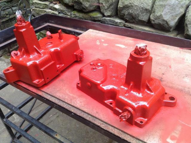

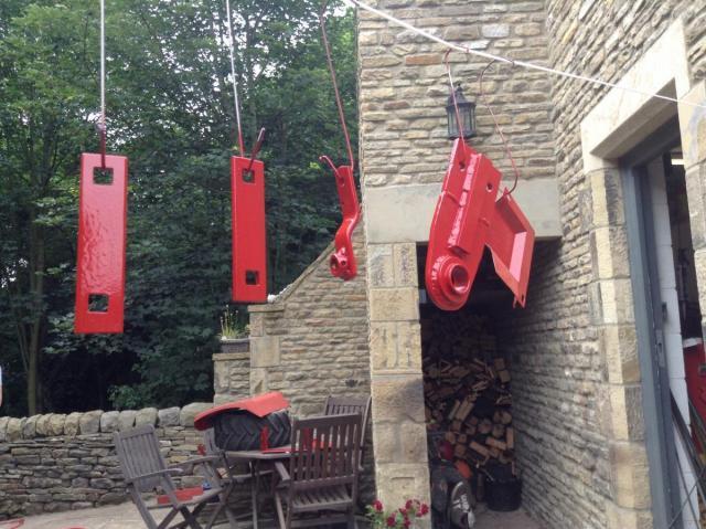

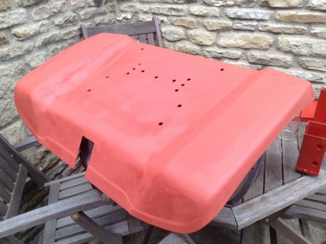

meadowfield 2,955 #147 Posted July 12, 2014 The weather has been good in the north of England today so I took the opportunity to do a bit of painting. The rear fender has had a lot of work done and a bit of sanding and primer was called for Had to improvise somewhere for drying Rear transmission all ready to put back together. 2 Share this post Link to post Share on other sites

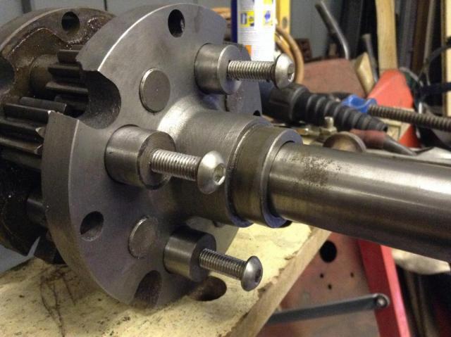

meadowfield 2,955 #148 Posted August 15, 2014 been a while since an update... firstly beefed up the hubs and cleaned up where they were hacked - also made them impossible to slide inwards completed the rear transmission and difflock shortened and rebushed the brake/clutch pedal made the bearing carriers for the intermediate tensioner added the final bracing on the rear subframe the pile of bits to complete the intermediate drive hopefully will get a few hours in the workshop this weekend.... 1 Share this post Link to post Share on other sites
