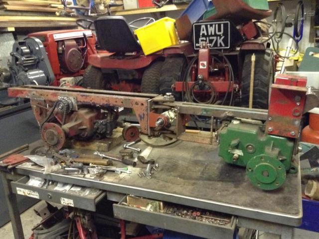

meadowfield 3,208 #103 Posted March 29, 2014 Wow looking great mark! Wil this one have a 3point? Koen Verstuurd vanaf mijn GT-S6810P met Tapatalk Thanks...nEventually yes! Haven't looked in for a while. Good to see your making progress Mark. Tyres look the same as my Duros . Great find on the Engine. Will you need a Tensioner on the Drive Transfer Chain like the C4?. Fab Fabbing and design . Same duro as yours Richard, hoping engine is a good one. Drive will be similar to the C4, though I might be changing the bearing I did last night Green and red reminds me of Meccano rather than Lego. That's my dad's old norlett gearbox....hence the green :D Share this post Link to post Share on other sites

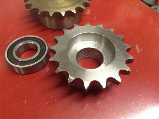

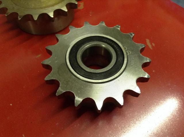

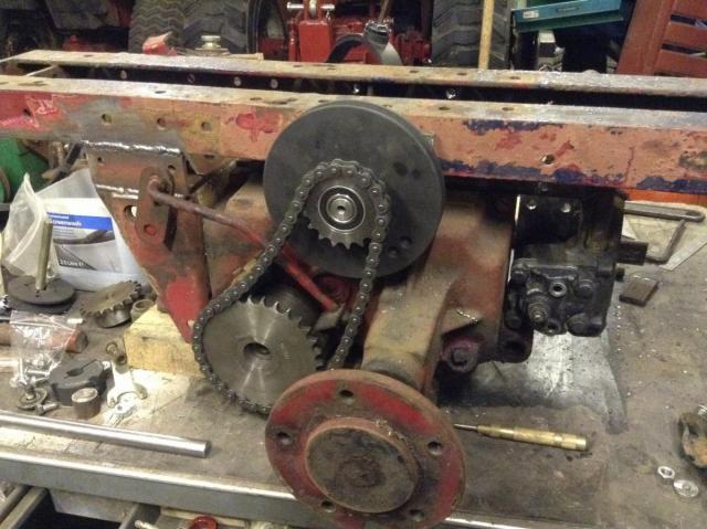

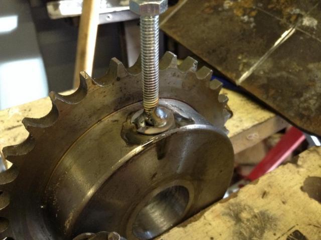

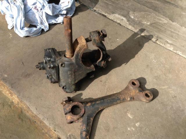

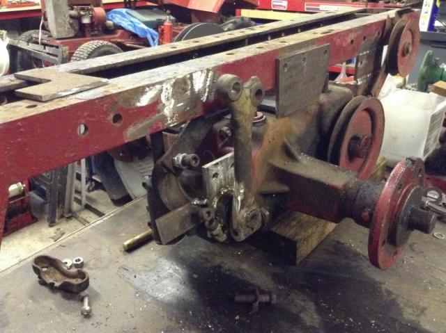

meadowfield 3,208 #106 Posted April 7, 2014 (edited) Lots and lots of lathe work over the last few weeks... Turning out another brake drum took time - hard work from the rear turning cast steel. On the last of the threads cut to hold the two halves together I broke a tap that's the first one I've broken in forever. I guess it had done its time. I tried the old way of welding a stud through a washer but it kept shearing the stud above the washer. No choice but to cut a fresh hole and thread. Dry run showing elevated drive, clearing front drum quite nicely. I made a start on the steering, this 1972 VW beetle steering box will do quite nicely Making a bracket to mount it vertically is interesting!! That's it for now, more goodies on the way. Yet another change of plan on the drive. I've ordered two hardy spicer UJ's which I think are the way to go. The change of plan means I have to reverse the drive though :( Edited April 7, 2014 by meadowfield Share this post Link to post Share on other sites

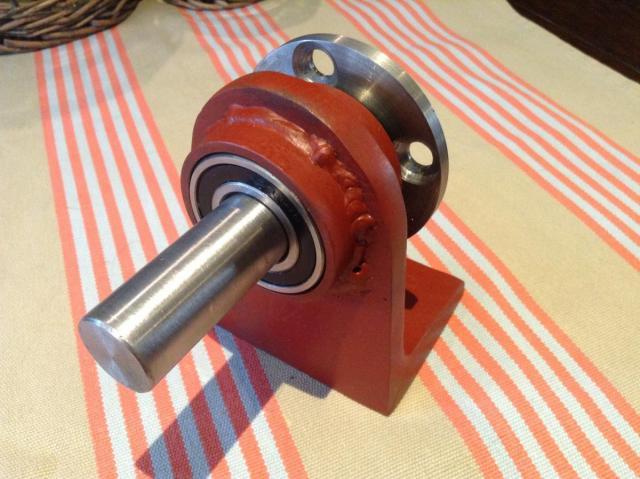

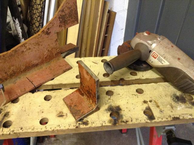

meadowfield 3,208 #109 Posted April 12, 2014 Distracted with lots of other things at the moment, but managed a few hours with the grinder and lathe... Turning this Into this It's the front prop shaft bearing holder and flange. Still got the keyway to cut and mounting holes to do. On jollies for a week, so there will be zero progress for a while. :D 2 Share this post Link to post Share on other sites
Stigian 1,235 #110 Posted April 13, 2014 Good to see some more progress Mark, it will be interesting to see your change in drive plans.. Good paint work on your front prop bearing holder, you managed to paint it with getting any red on the table cloth Share this post Link to post Share on other sites
wheeledhorseman 579 #111 Posted April 15, 2014 Neat fabrication there Mark! Good conversation piece when placed on the dining table at meal times! Andy Share this post Link to post Share on other sites

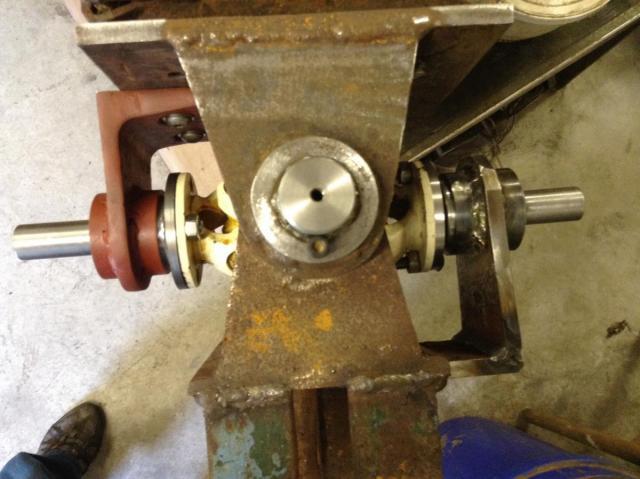

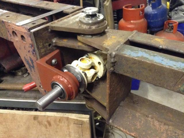

meadowfield 3,208 #113 Posted April 20, 2014 Quick update, more cutting and turning. One half in place with double hardy spicer in situ. 1 Share this post Link to post Share on other sites
meadowfield 3,208 #114 Posted April 21, 2014 Other side done, I can now pass the drive from the front to the rear 5 Share this post Link to post Share on other sites

C-101plowerpower 1,606 #120 Posted May 3, 2014 looking great mark, prius drive? looks really good and seams to work even better, can't wait to see this one finished Koen Share this post Link to post Share on other sites
Stigian 1,235 #121 Posted May 3, 2014 That's a real feat of engineering Mark Share this post Link to post Share on other sites

meadowfield 3,208 #123 Posted May 4, 2014 Hmm i like the sound of your kohler Mark LOL... Btw really nice fab there Mark.. Ha, it's makita Thanks Cool, what is this one called project c4 super bendy? James this is project bendy, an articulated Raider 10 - soon to be 16 looking great mark, prius drive? looks really good and seams to work even better, can't wait to see this one finished Koen I never though of the hybrid drive Koen... You got me thinking That's a real feat of engineering Mark Thanks Ian Really nice job there. I love stuff like this. Thanks!!! 1 Share this post Link to post Share on other sites
HorseFixer 2,015 #124 Posted May 11, 2014 Looking GOOD Mark! She's a TWISTY BENDY for sure. ~Duke Share this post Link to post Share on other sites
posifour11 723 #125 Posted May 12, 2014 I was wracking my brain, trying to figure it out. Then I saw the U-joints. Makes total sense now. Share this post Link to post Share on other sites
