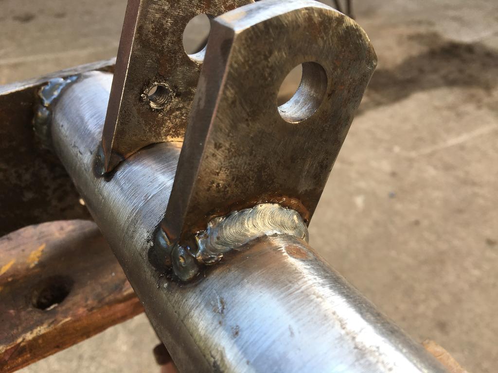

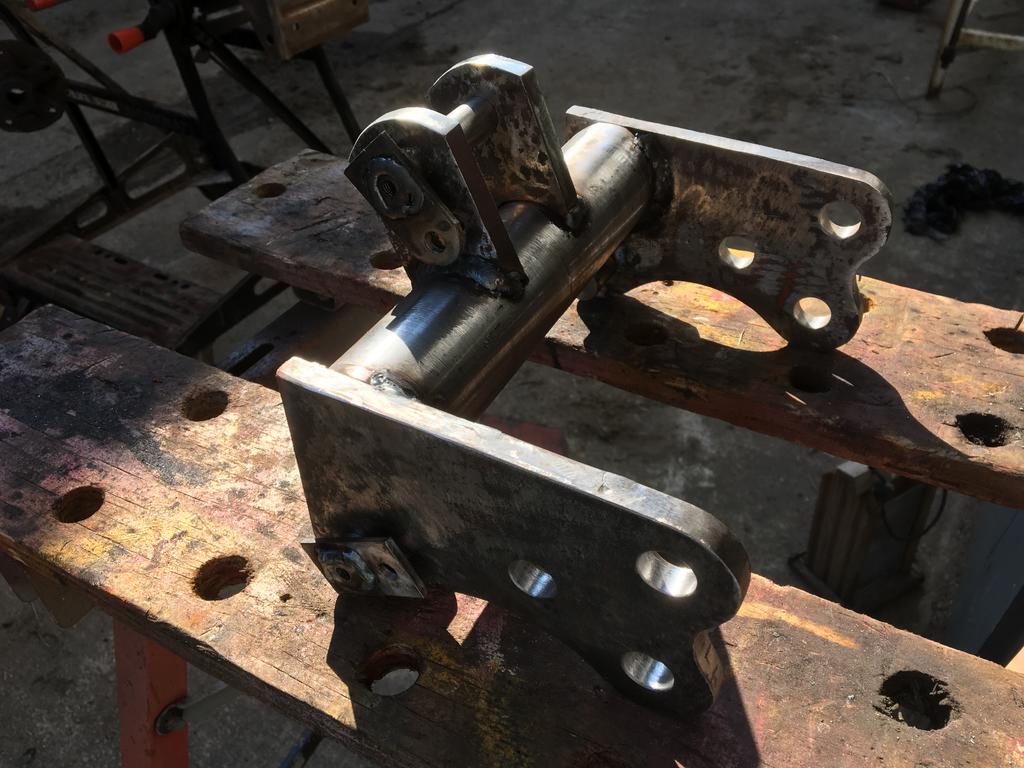

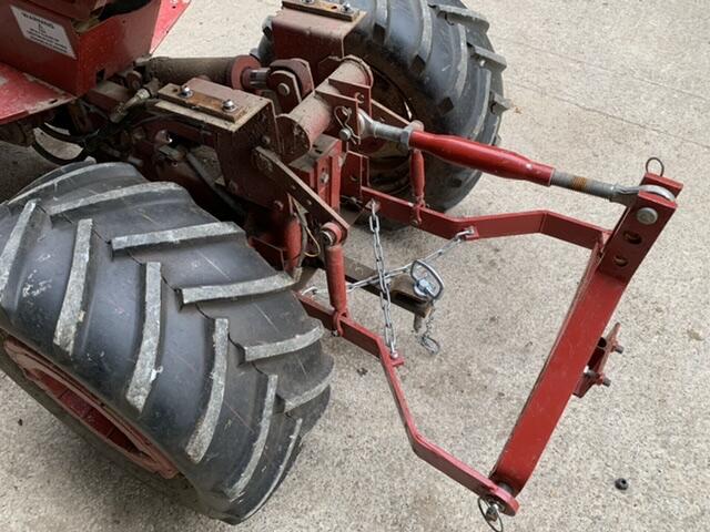

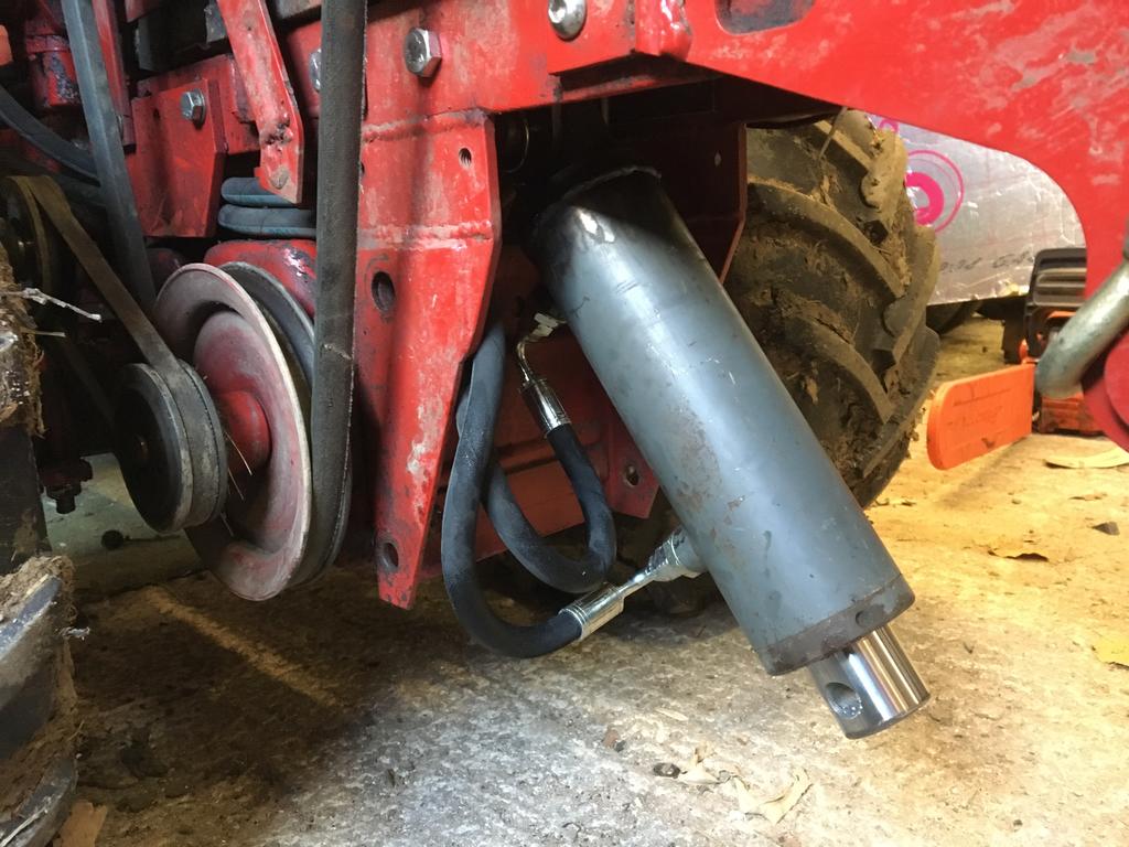

meadowfield 3,117 #251 Posted May 1, 2018 (edited) it's tight in there, but now the front cylinder is plumbed in need to start the hitch next... Edited May 1, 2018 by meadowfield 2 3 Share this post Link to post Share on other sites

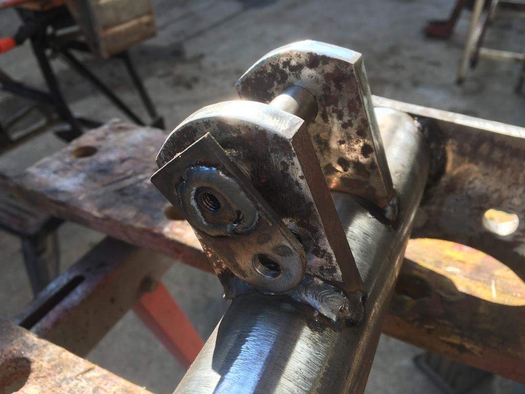

meadowfield 3,117 #252 Posted May 9, 2018 A bit more work... 4 1 Share this post Link to post Share on other sites
meadowfield 3,117 #253 Posted May 9, 2018 and a video 3 Share this post Link to post Share on other sites
peter lena 9,989 #254 Posted May 17, 2018 your bombproof chassis mounting points will make that tractor move without effort, good going, pete Share this post Link to post Share on other sites
19richie66 17,931 #255 Posted May 17, 2018 Nice beefy bit there. Waiting to see what you have in your head for the rest. Trying to picture it but a bit foggy. Share this post Link to post Share on other sites

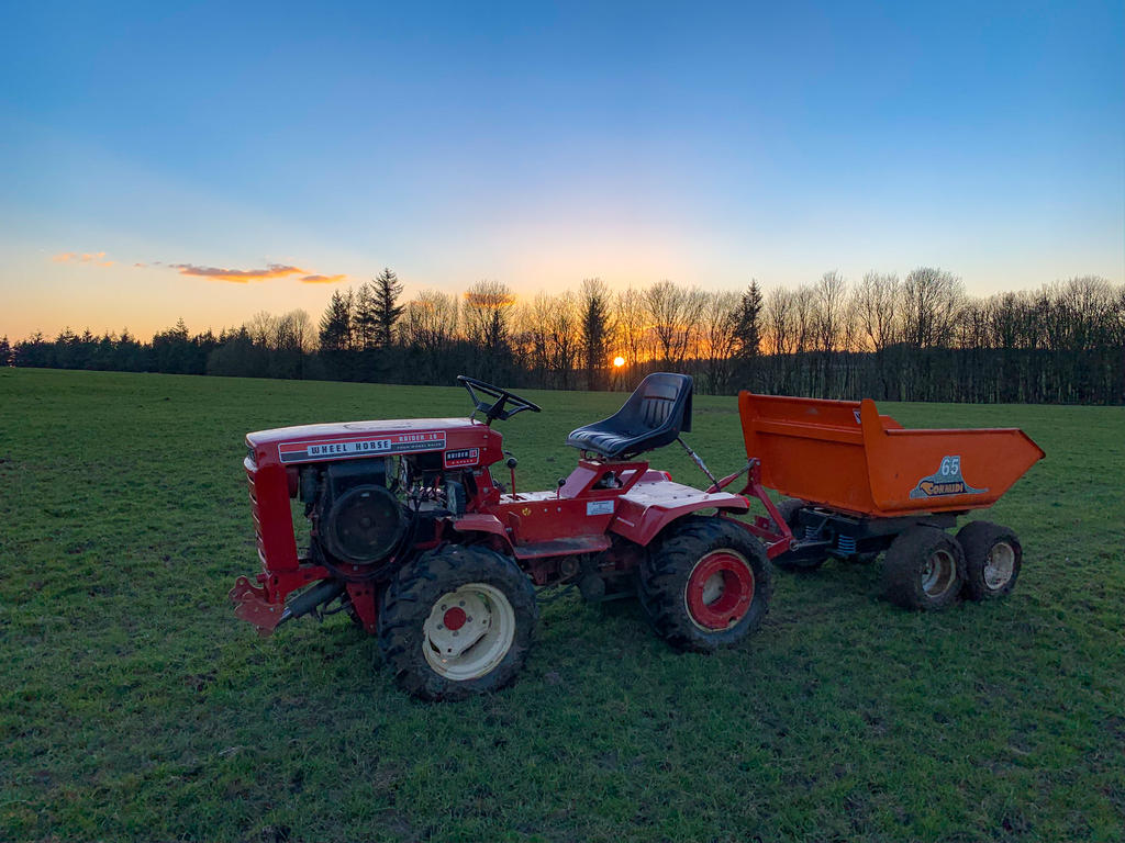

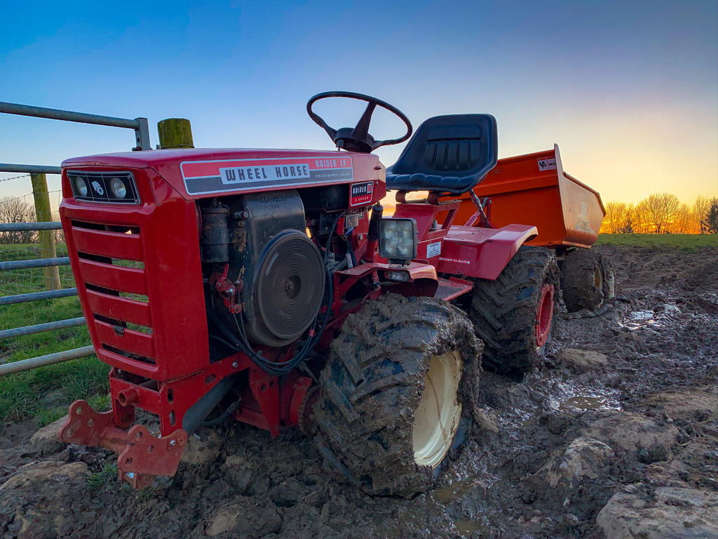

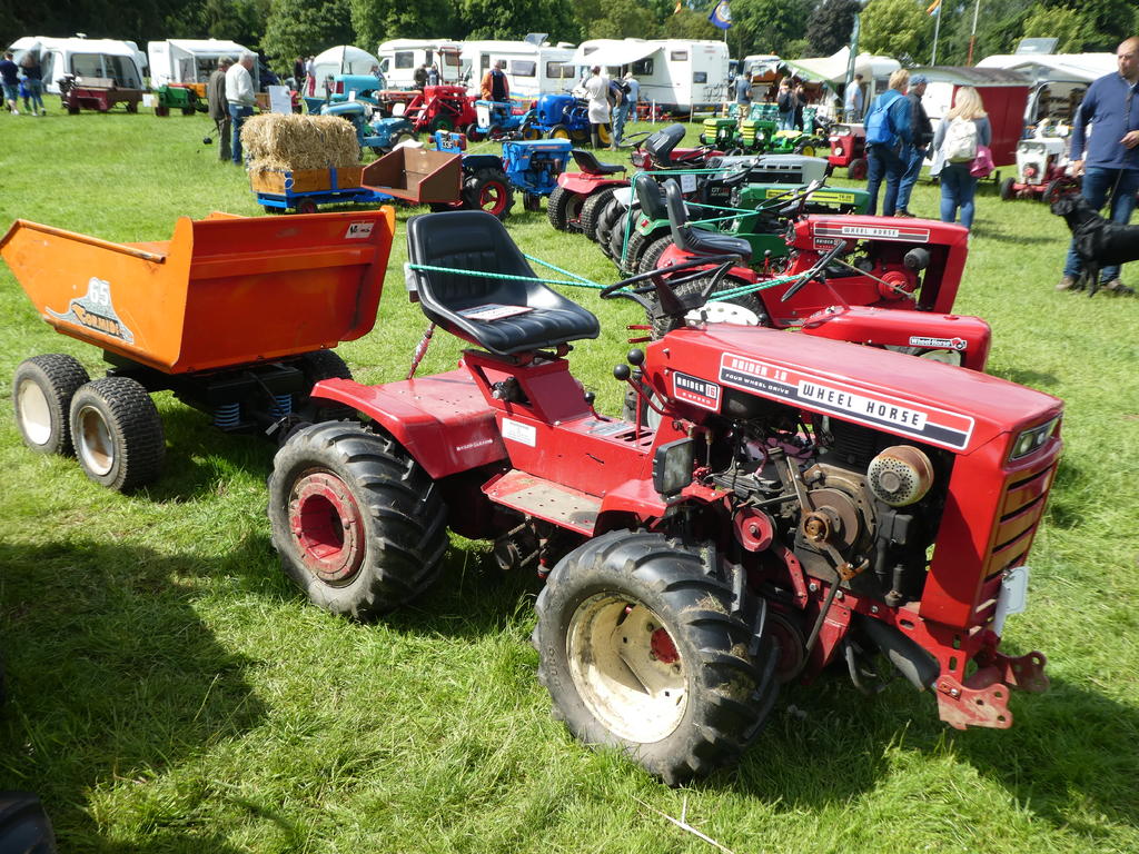

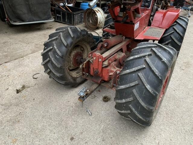

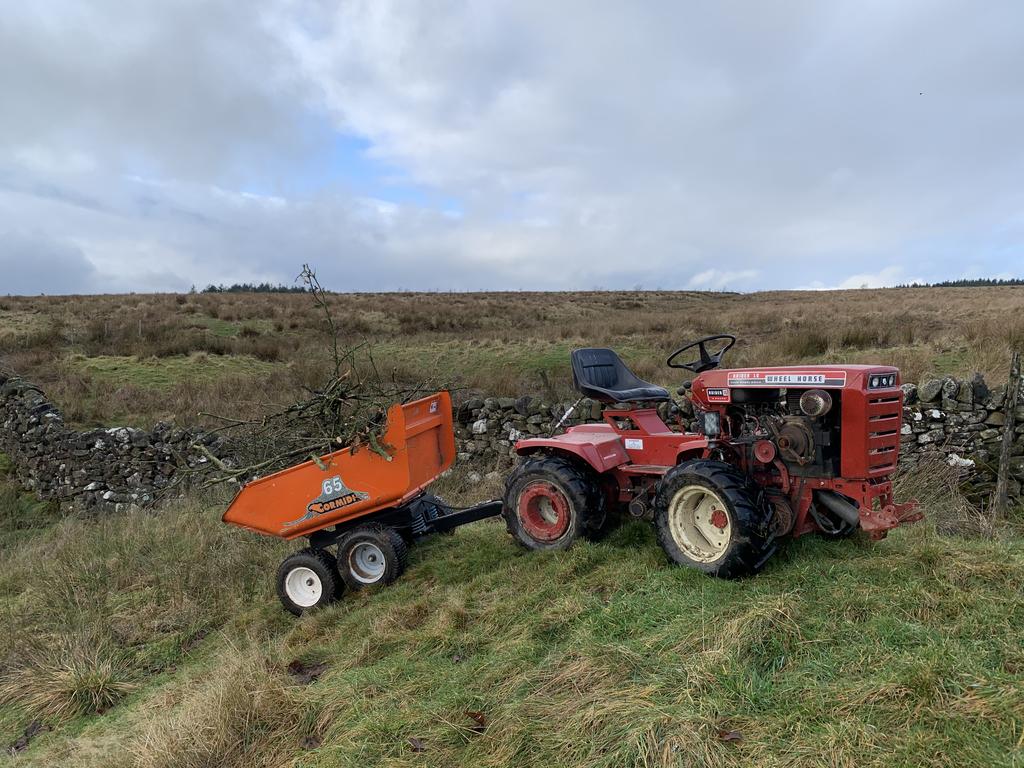

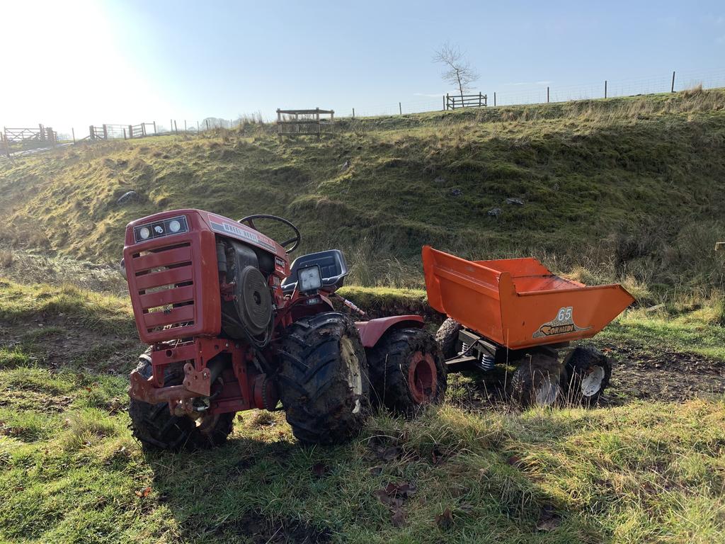

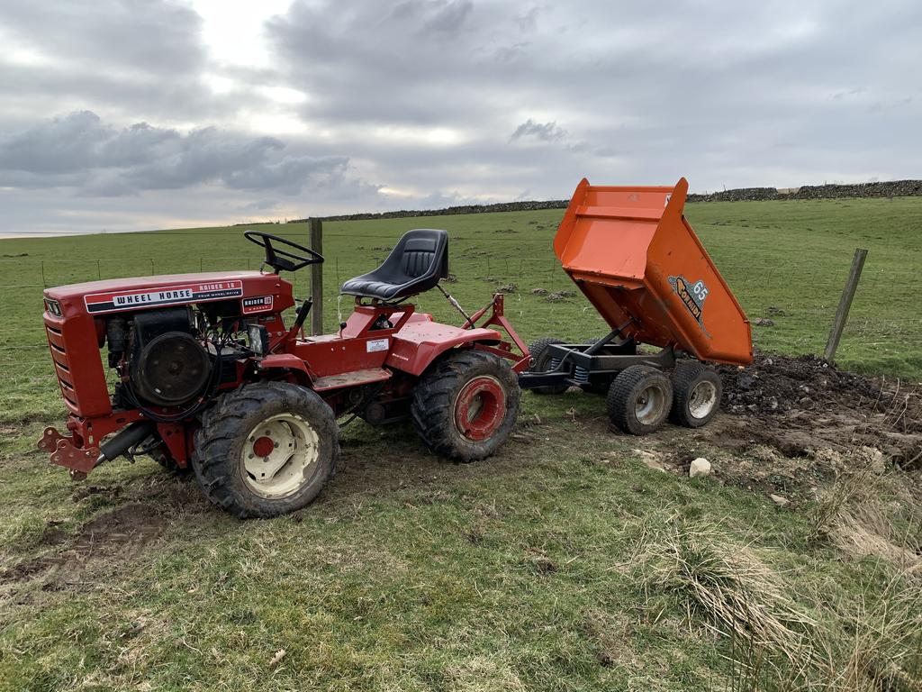

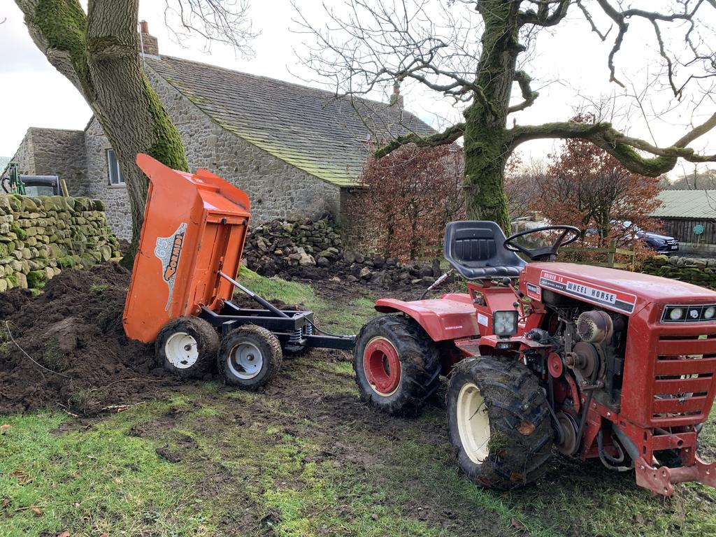

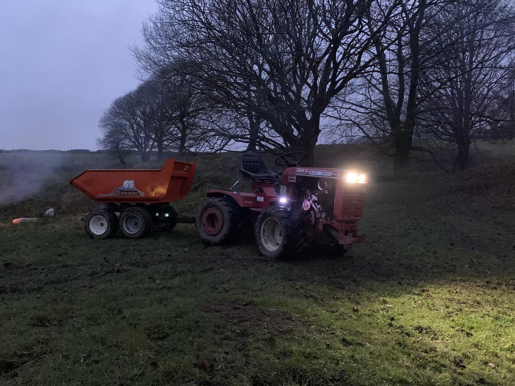

meadowfield 3,117 #261 Posted March 24, 2020 (edited) here's a few pics from the last year. Bendy gets used pretty exclusively with a half ton dump trailer. It's been worked hard and been pretty reliable apart from the other night.... Edited March 24, 2020 by meadowfield 3 7 Share this post Link to post Share on other sites
Pullstart 70,969 #262 Posted March 24, 2020 So..... what broke? Awesome pics! Share this post Link to post Share on other sites
peter lena 9,989 #263 Posted March 24, 2020 terrific job on that ! what ever broke, is the result of you being able to overuse what ever you designed in to it. without a doubt you will see / find the failure point and make it much better . your mechanical views are very interesting , and very functional . you will correct and detail the problem away , making that failure point , one of the best features of the tractor, you can quote me on that . your work reflects your intent, pete 1 Share this post Link to post Share on other sites

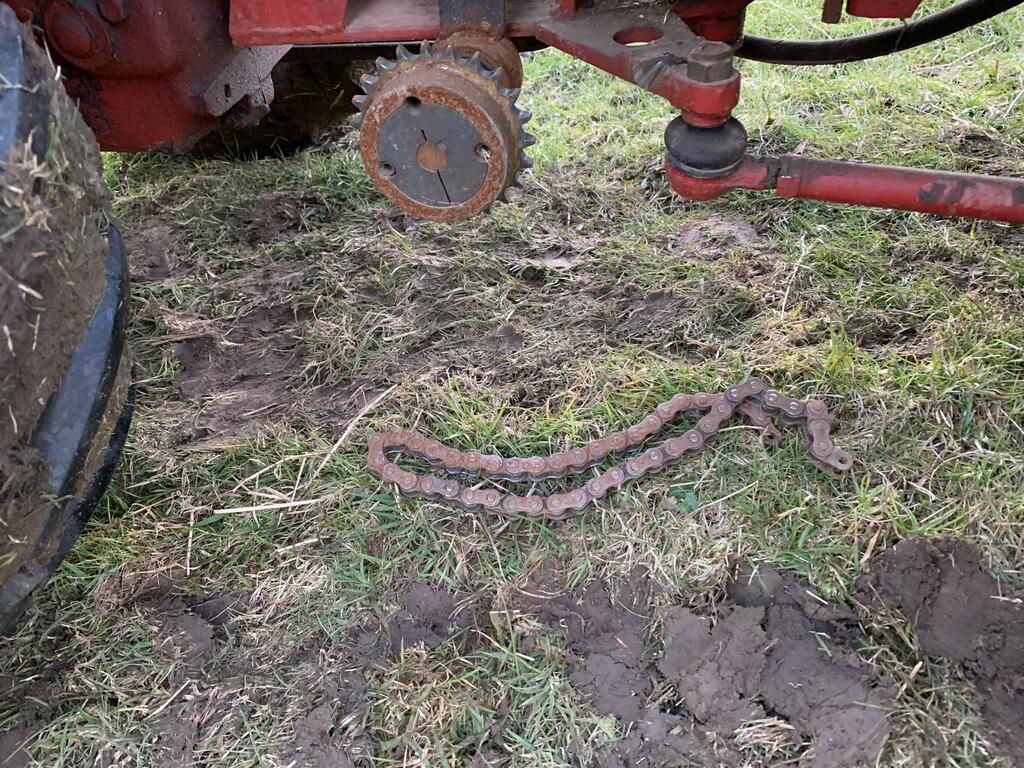

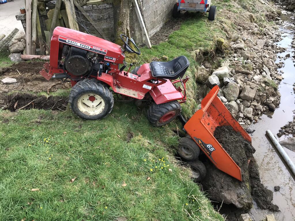

meadowfield 3,117 #264 Posted May 11, 2020 Just realised I never continued.... things went awry here as work stopped and life changed... the connecting link on the chain for the rear drive snapped! on a hard climb uphill but fortunately I was empty. Front wheel drive is useless on this thing so I had a mile and a half drive back on a surface road home. easy fix and bendy was soon back out on duty however a few weeks later the handbrake failed to hold with 1/2 ton in the dump trailer Fortunately I was at the side and could only watch it slide into the stream. the rear frame is twisted, and the centre coupling took the brunt of the jack knife. The dump trailer and rear hitch were the life saver as otherwise it could have been worse! 1 4 Share this post Link to post Share on other sites
Pullstart 70,969 #265 Posted May 11, 2020 I’m sure it’ll be working better than ever when you’re back up and running Mark! 1 Share this post Link to post Share on other sites

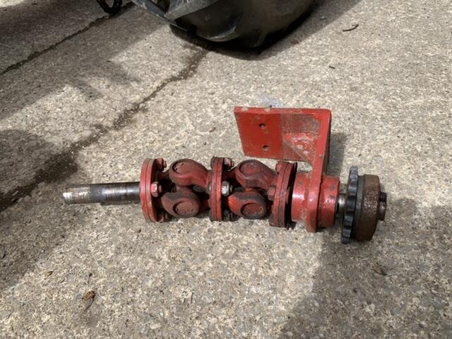

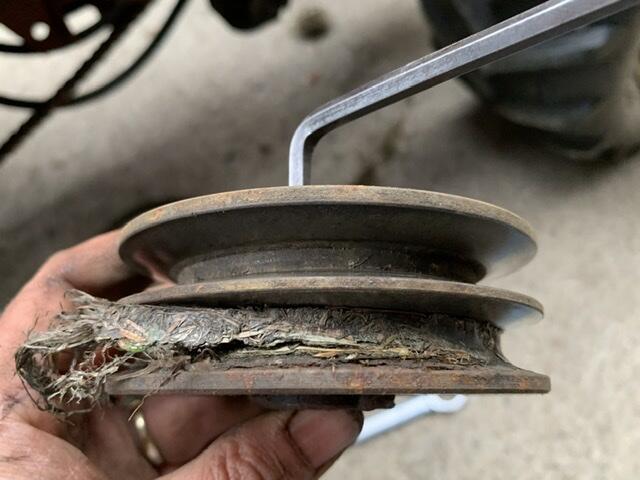

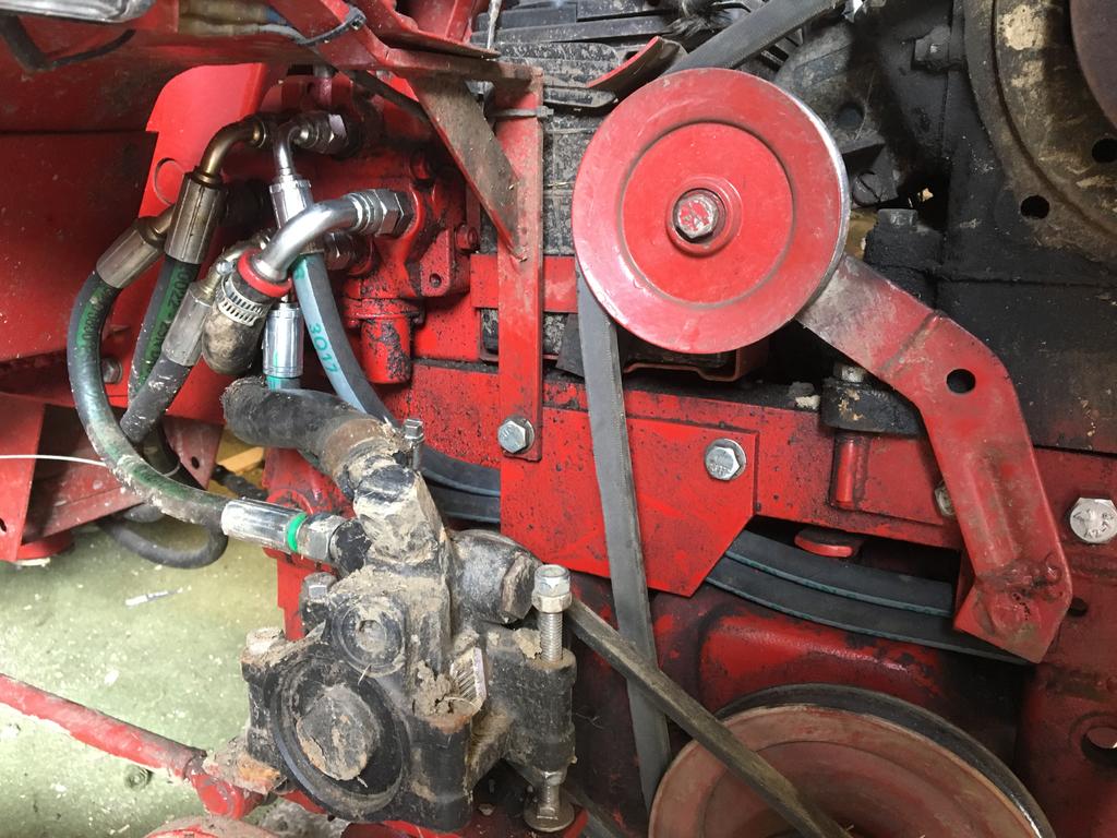

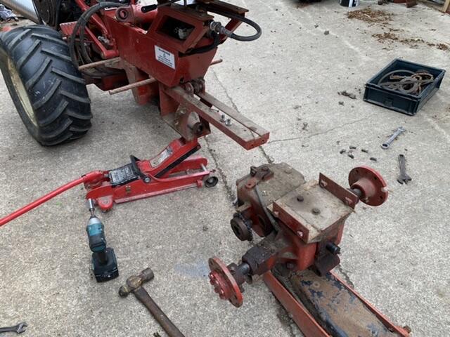

meadowfield 3,117 #266 Posted May 21, 2020 After pushing my luck and working it behind its means, it’s time to sort the niggles. As ingenious as the connection between front and rear is, there are a few issues. 1. The belts get wet and slip. 2. They get grass trapped in them 3. The axle tilt puts strain on the crossshaft. so time for a strip down and rethink... its been running for over five years, so not too bad. I think running with 1/2 ton in a trailer has taken it beyond its limit. fender off pulley full of grass 3 point removed. tomorrow I’ll split the two halves and work on a plan.... 2 2 1 Share this post Link to post Share on other sites

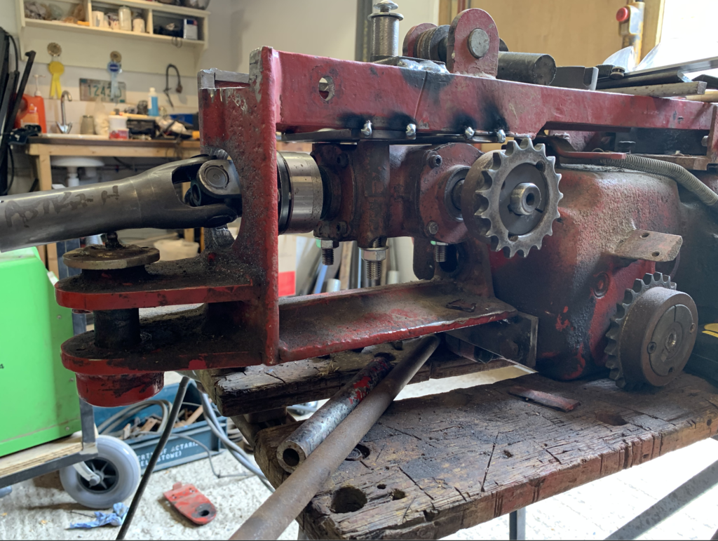

meadowfield 3,117 #271 Posted May 22, 2020 Centre coupling still as smooth as when it was made. rear end dropped remaining bit very well balanced 1 Share this post Link to post Share on other sites

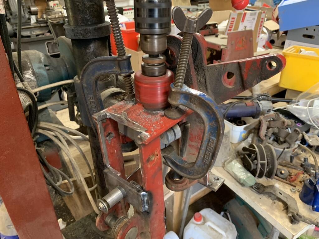

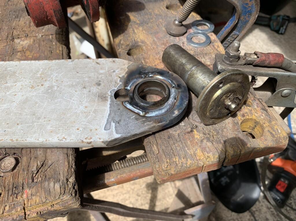

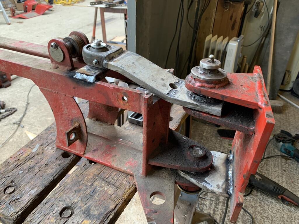

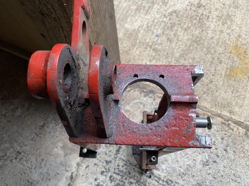

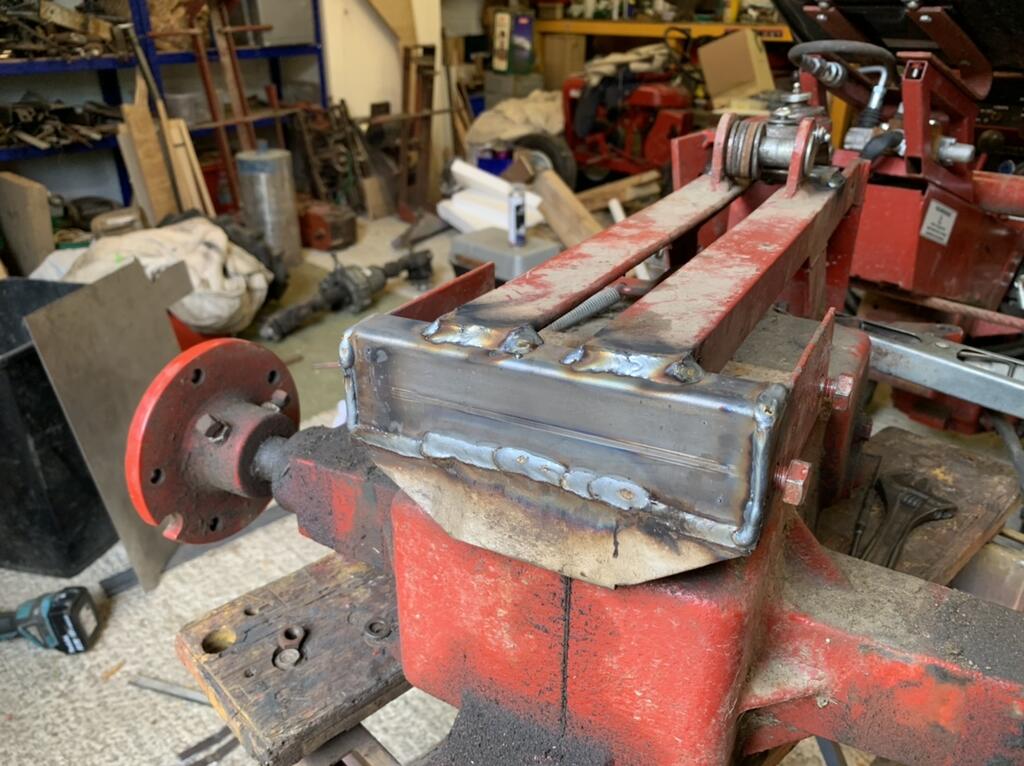

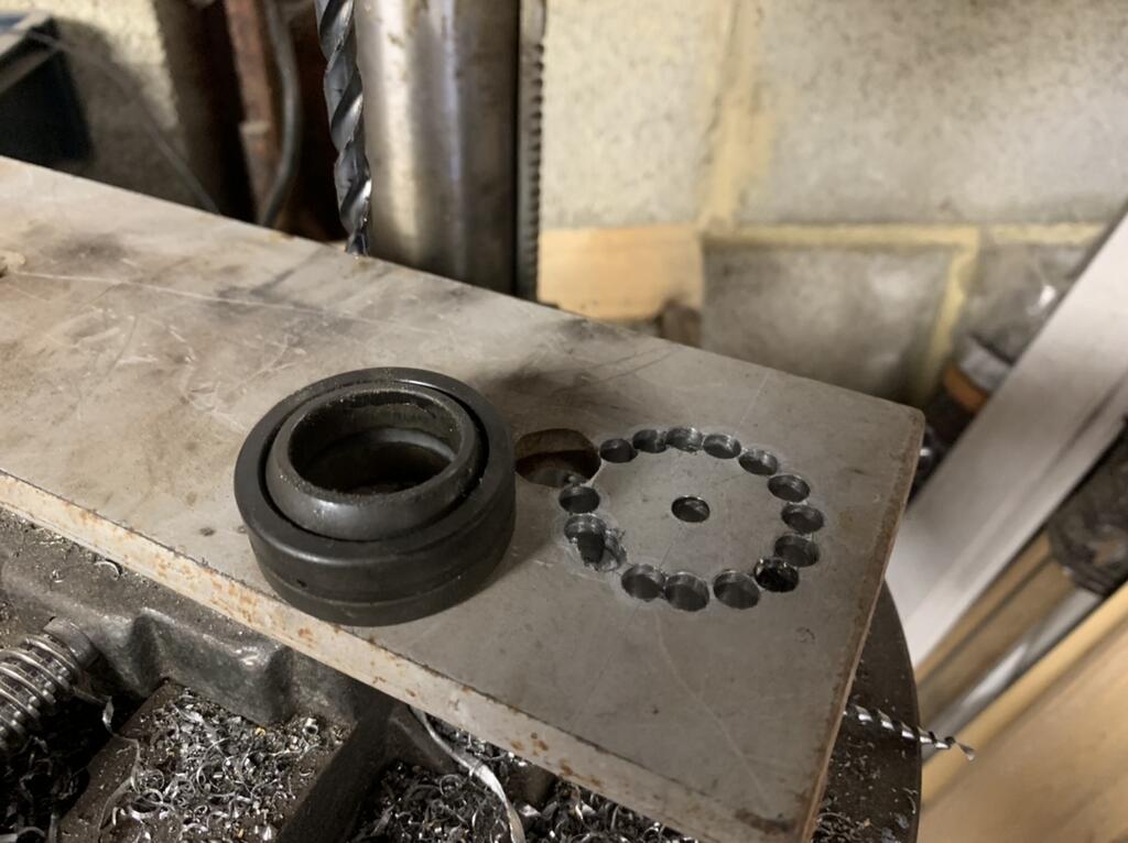

meadowfield 3,117 #272 Posted May 23, 2020 Today’s update, the centre coupling gets a makeover. firstly the design is changing which means it needs 1” spherical bearings in the middle. No 1-3/8” hole saw so had to improvise. rear end now floats in a different way, the fall had damaged it and it wasn’t easily repairable. so now the floating rear end is welded up. and the task of changing the driveline to longitudinal starts... 35 mins with a hole saw. mock up of rear end as I plan it to be... still a way to go! 2 3 1 Share this post Link to post Share on other sites

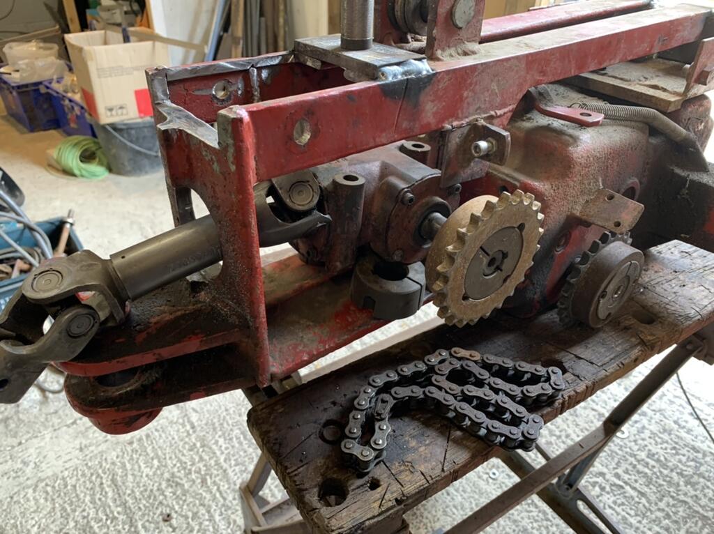

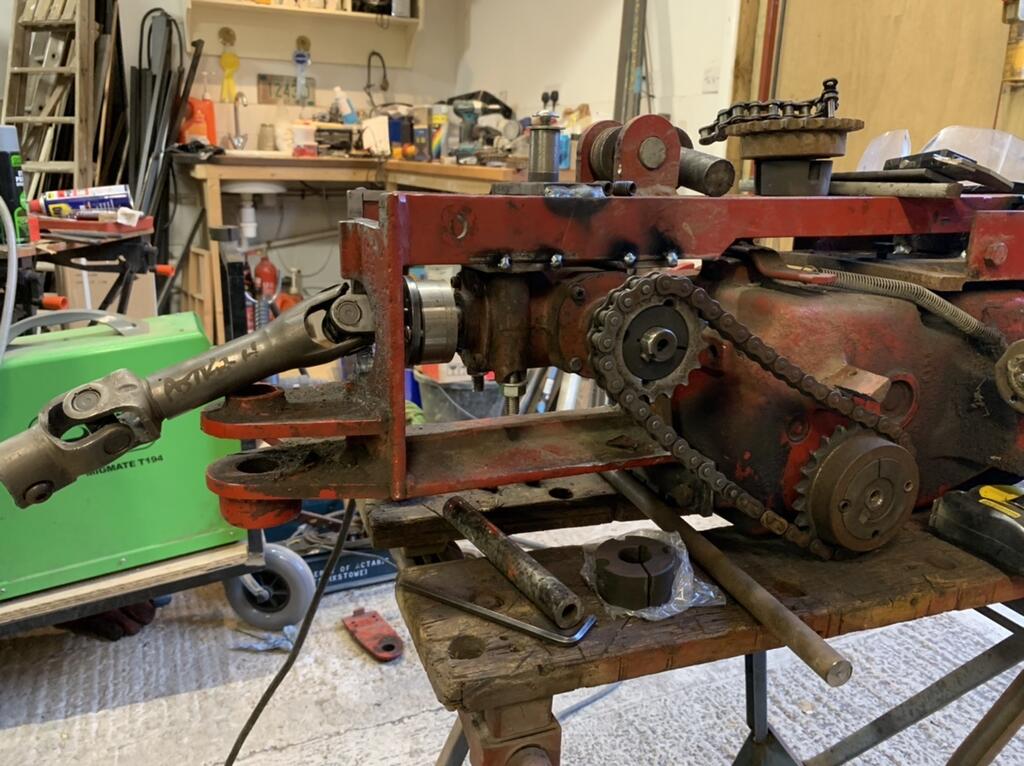

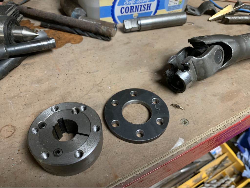

meadowfield 3,117 #273 Posted May 26, 2020 latest... I can't get hold of small mower deck shafts or the like, so had to make one from a car steering column. Gearbox in place now, just chain to add and tension. 1 1 Share this post Link to post Share on other sites
oilwell1415 563 #274 Posted May 26, 2020 It looks like you may even be lucky enough to use a preexisting tab on the side of the case for a chain tensioner. Share this post Link to post Share on other sites
meadowfield 3,117 #275 Posted May 26, 2020 6 hours ago, oilwell1415 said: It looks like you may even be lucky enough to use a preexisting tab on the side of the case for a chain tensioner. The rear 90deg box slides to adjust so no plan to chain tension. Plus the tab has had to go to fit the chain... 3 Share this post Link to post Share on other sites
