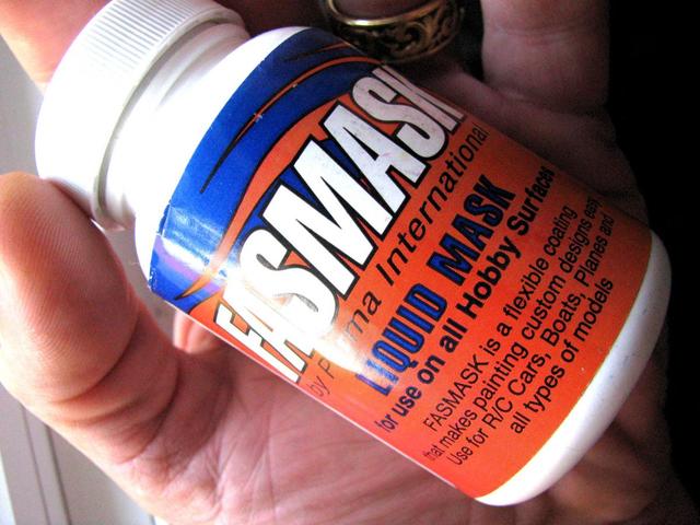

AMC RULES 37,254 #7 Posted June 2, 2013 They do make a liquid mask for detail work. 2 Share this post Link to post Share on other sites
