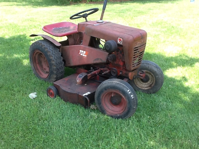

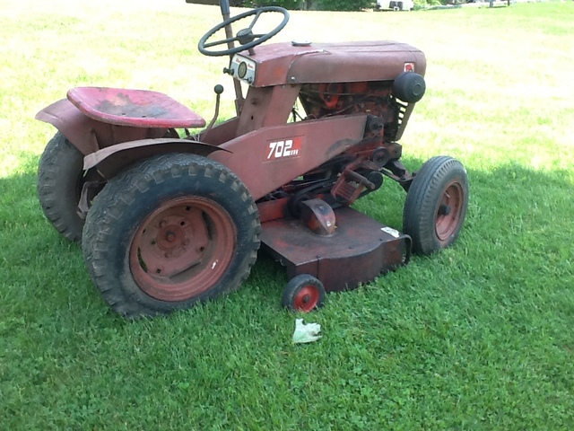

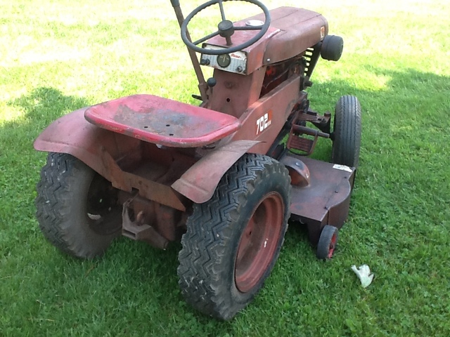

I ended up being the only one to bid on this tractor and won it. Can anyone confirm what model it is by the pics? The ad says 1962 and it looks like a 702 to me but not sure...

Looks like a 702 to me. Nice score, that should clean up real nice.
Jake Kuhn
I agree, looks like a 702. Has a 62 steering wheel, 62 clutch pedal, 61 and 62 steering setup, 61 and 62 lift setup, and also the same type of starter generator belt guard my 702 has.
Looks like a really nice score!
Pollack Pete
Looks like a 702 to me.You did good on the price.It looks much better than mine and I wouldn't let mine go for that price.Have fun with your new toy.
AMC RULES
Good looking :wh: for the money.
Ken B
Nice score Steve. Stealth mode too, I never saw that one. It looks to be missing the one guard on the left side, you probably have one in your treasure trove of parts though!

Everything looks to be 702 except for the transmission belt cover....the 702 had the indent where the 702 sticker is placed.
fireman
I was gonna go $300 max if I did bid. Glad you got it in stead of me. Vin's right, clean it up real good and flip at the show for $500!
buckrancher
702 with a non original belt guard
belt guard looks to be from a lawn ranger not a 701 as it has too many sloted holes

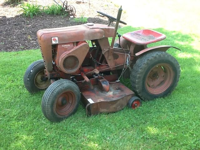

I was able to get pick this up today. Just got it off the truck and later tonight I will give her a bath. PO had the original drive belt cover with the 702 decal. Overall this tractor seems pretty nice and original. I will know more once I start to work on it and get it going. I plan on actually painting the rims white on this one and leaving the rest as is. It needs the left side plate and a drive belt. Anyone know the size of the drive belt for this machine? I hope to be able to pick up a nice original side cover at the show. Here are a few pics...
buckrancher
drive belt is 1/2" x 70"

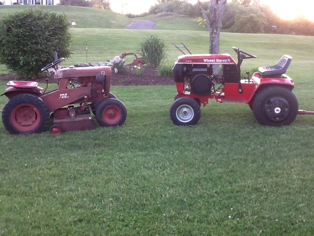

So.. got her running today and after a little seating of the valves it cleared up and ran great. I ended up mowing the grass. The tranny fluid was pretty bad. The shifter forks for 1st and reverse would not budge. I filled it with a degreaser and ran it around the yard to mow. I then drained the rear and filled it with fresh gear lube and low and behold the forks moved and shifts nice. No leaks anywhere. I think she will be a keeper. I will continue to tweak it here and there.
Here is a picture of my latest two finds. Funny how when you are not looking they seem to find you... lol

Is that a 310-8?
