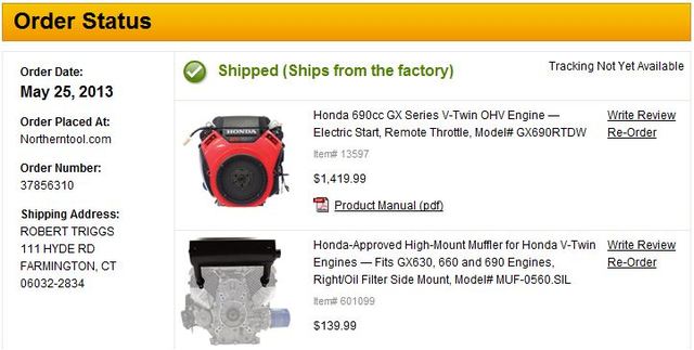

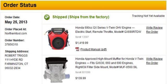

Wheelbearing 49 #38 Posted May 31, 2013 Well this is all I have from Northern Tool Really Really Antsy!!!!! Share this post Link to post Share on other sites
MalMac 1,337 #39 Posted May 31, 2013 By the looks of the picture of the muffler, the oil filter is on the front. Is there going to be enough room? Just being curious here starting to make future re-power plans for my 520. Share this post Link to post Share on other sites
Wheelbearing 49 #40 Posted May 31, 2013 By the looks of the picture of the muffler, the oil filter is on the front. Is there going to be enough room? Just being curious here starting to make future re-power plans for my 520. Lots of room Share this post Link to post Share on other sites
