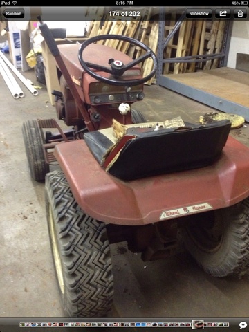

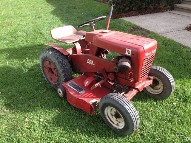

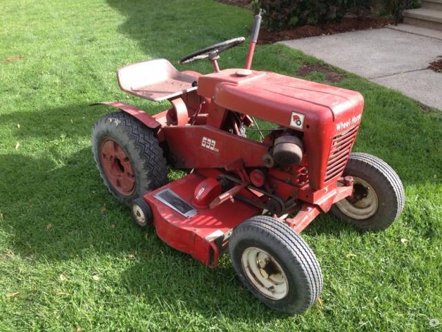

New purchases
Xjchief
633 Starts first pull runs and drives perfect
Commando 8 has spark but no compression
606 tecumseh no head and valves don't move

Pollack Pete
Nice.What engine in that?? Have fun with your new toy.

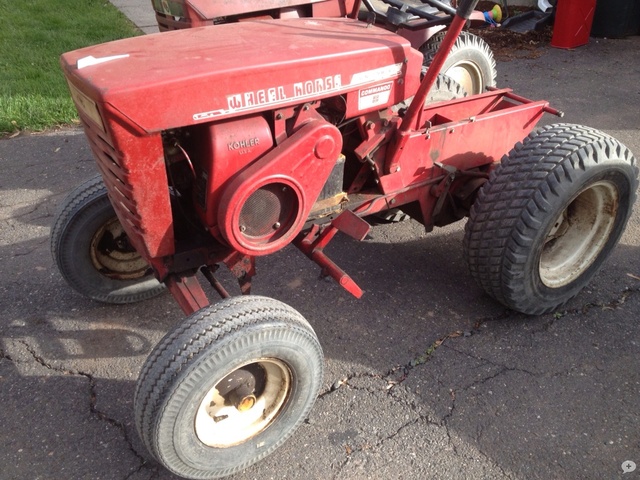

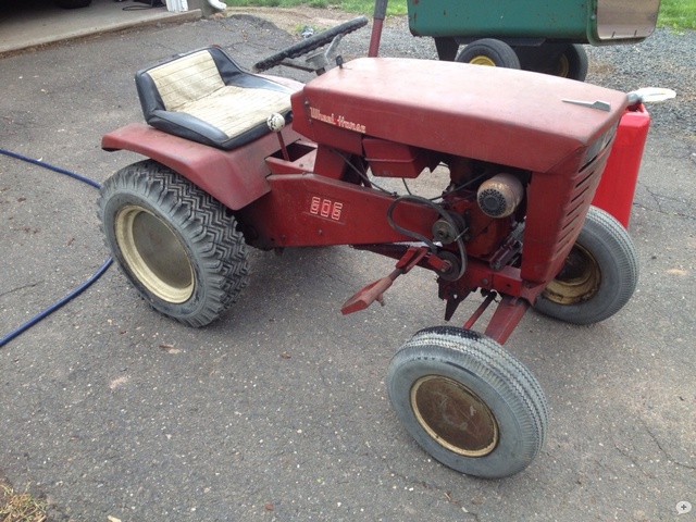

Xjchief
606
Commando 8
post-9395-0-94697700-1369610154_thumb.jp
post-9395-0-94094800-1369610197_thumb.jp
  • Like 1
Xjchief
Kohler k 141

stevasaurus
That is some real nice horses you came up with...the paint on them looks great.  Love the deck on the 633.  :)
Xjchief
Yea I thought so
U think the foot rest on the deck is original?
AMC RULES
Nope, nor the seat...easy fix though.  Great :wh: scores.    :handgestures-thumbsup:

For the 633 I was gonna go to tractor supply and get the universal seat pan till I can find an original

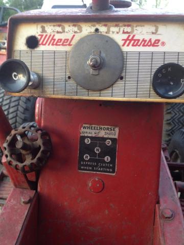

Is this correct ? What info can I get from the serial #

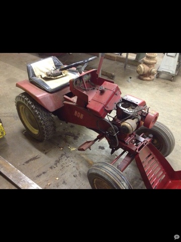

found the head and head bolts in a box of parts for the 606 that came with the tractor
does anyone have fenders and seat for the commando 8?
Retired Wrencher
:USA::wh: I have the seat for u with a wheel horse emblem in upper middle of the top pan can send picks if u return the favor. as for the seat pan or fender that easy on E-Bay.Gary     B...................

606

gwest_ca
Is the number 38003 or 38903?
Is it the 633?
Garry
Xjchief
My 633 is 38003

So I got the commando 8 going new connecting rod cleaned carb battery fired right up
What drive belt should be on it it's a wheelhorse 9691 cus the transmission pulley doesn't stop enough to put into gear any thoughts?
gwest_ca
9691 should be the correct 1/2" x 70" belt.
Is the belt guard installed? Must be on to force the belt slack to the engine pulley.
