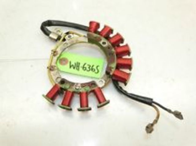

Here's the only pic I can find - so no prizes for guessing who has one up for sale at present on a well known auction site not to be mentioned here.
I'm guessing the six coils are the lighting and the four coils are charging. Not sure how the charge coils are configured but certainly on the side in view two tails are earthed.  Possibly there another pair earthed on the other side or maybe  pairs of coils are in series but either way it's possible for a poor earth here to result in a kind of series arrangement that would result in higher volt output but a very strange waveform.
Given that the headlamp circuit doen't light the bulbs either despite the voltage reading then maybe its the stator frame thats not earthing to the engine as a result of corrosion and all the coils are interacting to give the weird readings.
Thoughts?
Save Old Iron
Thanks Andy, that helps.
I think we are all in uncharted areas here. The resolution will most likely come from investigation and not anyone's past experience with a similar issue.
I hear your point about possibly having the two coils somehow wired in series so their outputs are added together. What incredible luck the two outputs would also be in phase and additive instead of subtractive!  But I guess that depends on magnet arrangement too. All coils may not be energized at the same time to allow phasing to be a player here. But anyway ............
Lets say we added both together. Lets say 17 RMS for the charge circuit and 14 RMS for the light circuit. That still only adds up to 32 volts total. Not 90 volts. I remember the screen print Mark took of his stator output on a digital scope showed the stator AC voltage to be fairly sinusoidal in shape so a standard off the shelf digital meter should not have much trouble giving an accurate reading.

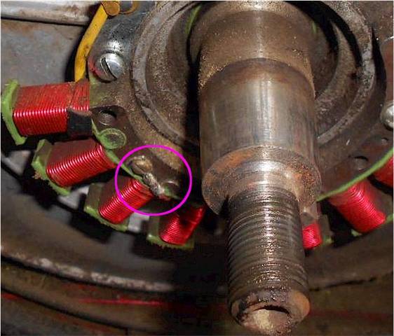

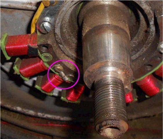

Again, the next best step forward in my opinion is for an eyes on picture of what QD-16's stator and magnet arrangement look like on the tractor.

qd-16
Here are some pics.

A couple of points that may help with this mystery - firstly, according to the Kohler fault finding guide for the 3 amp charging system disconnected from the battery is that as long as the output at 3000 rpm is '28 volts or more' then the stator is okay.
They don't give the reading for the lighting circuit but I'd put money on it possibly being about the same so 33.7 volts measured on the lighting output seems reasonable - the mystery is the 90 volt reading on the charging output - though technically speaking it meets the Kohler spec of 28 volts or higher..
I've read elsewhere that these engines do have the full compliment of magnets in the flywheel and that you can 'upgrade' to a 10 amp or 15 amp stator and rectifier regulator to rewire the tractor in the more conventional way. I think then we can discount the flywheel / magnets as a cause.
I think I'd begin by checking engine rpm that it's not over the 3000 rpm mark at full throttle - to eliminate it from the overcharging issue if nothing else.
Then I'd remove the earth tag to separate it from the stator frame and measure the resistance of each circuit to the tag.
.post-4509-0-03690100-1369340426_thumb.jp
According to Kohler, the resistance from the lead to the diode (stator side) and the earth tag should be 0.7 - 1.3 ohms.  The resistance of the lighting coil lead (yellow) to the tag should be about 0.4 ohms. There should be no continuity (infinite restance) between either of these leads and the stator frame while the earth tag is removed. The above resistance readings should remain constant if the tag (that looks as though it's crimped on) is wiggled a bit.
Check the coil resisitance readings (but to the stator frame) once the tag is screwed down to it, and again to the engine block once the stator has been secured to it.
If all this checks out then your system has passed the Kohler fault finding guide (assuming 3000 rpm) and it is a real mystery. You are not alone though! In this thread
