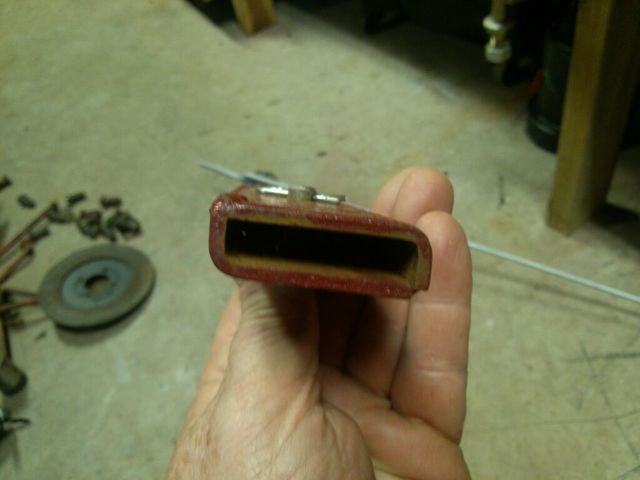

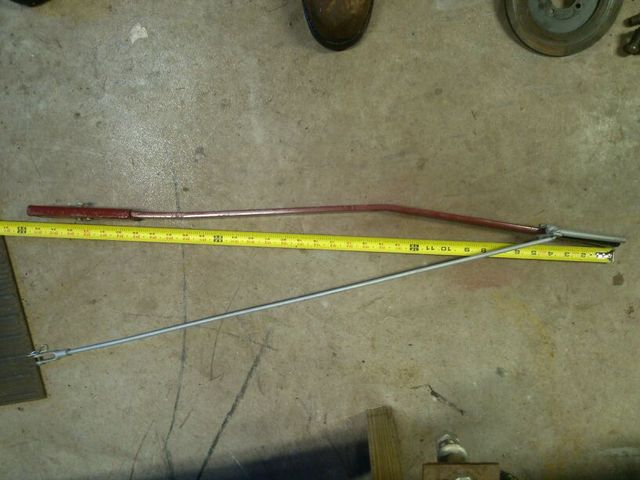

Picked up a D pushblade, missing the handles but otherwise in good shape. Anyone have a good picture of the handles along with some measurements or a set they would like to sell. PO took them off to store it and lost them.
  Going to use it on one of the C 195's but I don't think there were any differances in the handles ?

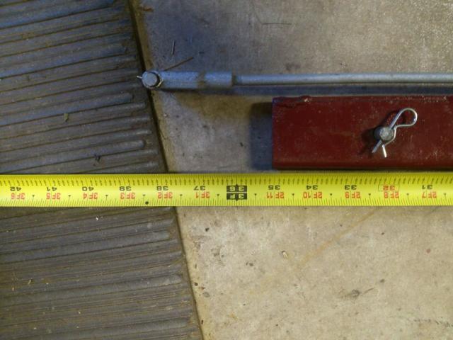

Just saw one on ebay. Don't know if you nabbed it or not. Found mine without a handle as well. Seems to be a common problem. I made mine out of 1" square stock. Would be happy to post some pics if you're still interested. I think it's better than the original, personally. But I might be biased.

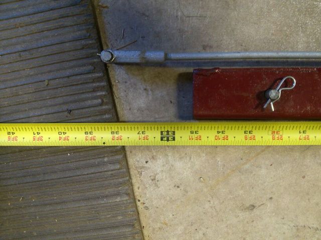

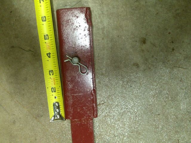

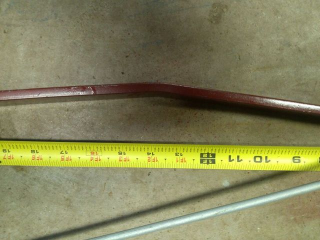

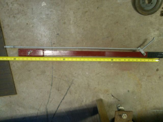

Hopefully this is what you are after.....post-1933-137141776513_thumb.jpgpost-1933-137141779818_thumb.jpgpost-1933-137141781504_thumb.jpgpost-1933-137141783368_thumb.jpgpost-1933-137141785377_thumb.jpgpost-1933-137141786795_thumb.jpg
Trouty56
Sorry some are upside dofwn....held the phone upside down. Lol

Thats what I need looks like I can use a regular handle cut it up to make it work and add  the lever for the lock. Shouldn't be to hard hope to find an extra handle at the show.

It is 1 1/4 x 1/4 steel. I forgot.to put that in the post. The bottom is the tricky part. It slides over the nub on the plow frame.
