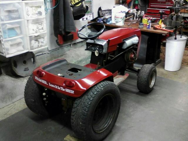

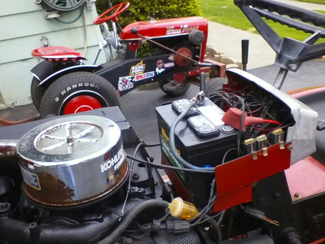

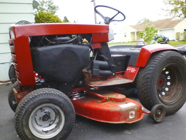

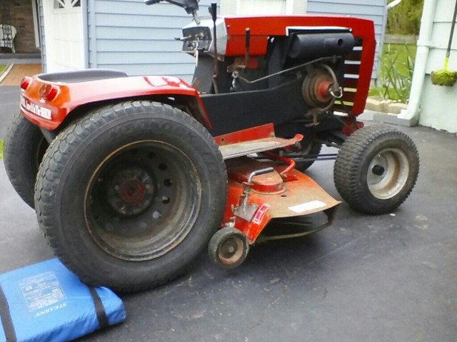

HorseWhisperer 243 #1 Posted May 19, 2013 I stuffed a KT 17 series ll in a C120 chassis.I added a 400 series fuel cell and fenders.I put on an electric actuator with correct rock shaft and relocated the battery to the factory gas tank home.Check it out.It's for grabs in classifieds and on buy/sell/trade on Fb. 1 Share this post Link to post Share on other sites
groundhog47 402 #2 Posted May 19, 2013 Nice work, like the back wheels, what size are they? I'll bet you can mow on/in idle! Also curious about mower mount up, is it standard C series. Have seen a few and passed up as thought wouldn't fit my C-120 mid mount attachment without retrofit whole system. Share this post Link to post Share on other sites
HorseWhisperer 243 #3 Posted May 19, 2013 Nice work, like the back wheels, what size are they? I'll bet you can mow on/in idle! Also curious about mower mount up, is it standard C series. Have seen a few and passed up as thought wouldn't fit my C-120 mid mount attachment without retrofit whole system. Thanks,the wheels are straight off a 96Camry.the bolt pattern is the same as well as full size Ford cars and half ton pickups.The deck is original to a 70 electro.the only mod was the the incline bump stop on the front.It's the adjustable 1/4 rod with the little flat round rubber foot on the carriage itself.I just moved it to the right a couple inches away from the belt pattern.It works like it came from the factory. Share this post Link to post Share on other sites

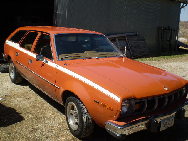

AMC RULES 37,251 #11 Posted January 23, 2014 Not the best image, but these are the rims. 1 Share this post Link to post Share on other sites
smoreau 658 #12 Posted January 23, 2014 Now that's a grocery getter! I would take the other two rims that your not using, thay would look great on a rat rod Share this post Link to post Share on other sites
HorseWhisperer 243 #13 Posted January 23, 2014 Sweet color,what is that called?I think those rims are gonna look awesome! Share this post Link to post Share on other sites
AMC RULES 37,251 #14 Posted January 23, 2014 1976- Firecracker Red. Share this post Link to post Share on other sites
