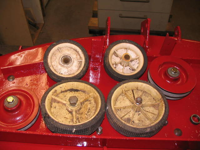

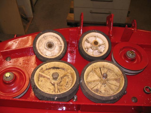

pacer 3,181 #1 Posted May 15, 2013 Theres been so many tire/wheel posts lately, I thought I'd ask one too... I need to replace the deck wheels on the deck of this 1054 I'm rebuilding and am puzzled about the diameter of the originals. The deck is a RM-485. The ones that were on it from the seller was a crappy cheapo plastic thing that is all cracked/broke. The size is about 4 1/2" and all I can find is 6" (or larger) I have to wonder if I go to 6" if they would affect the blade/deck height settings, so, do I need to keep looking for the 4 1/2" or would a 6" not be a problem? I got a feeling that the PO just stuck whatever he could get hold of, which happened to be the 4" Heres a pic of the crappy 4's and a pair of 6's that I had laying around--- Share this post Link to post Share on other sites
gwest_ca-(File Mod) 12,532 #2 Posted May 15, 2013 110506 Replaces 2663 4121 5169 5305 106022 Stens HD 210-013 6"x1-3/4" Garry Share this post Link to post Share on other sites
pacer 3,181 #3 Posted May 15, 2013 OK, I had pretty well figured they were 6", but wanted a little assurance... Thanks Share this post Link to post Share on other sites
