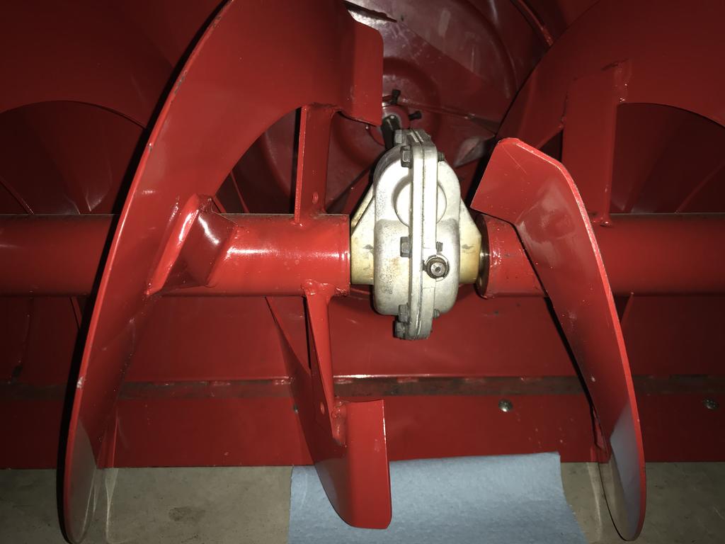

Ike 76 #9 Posted September 9, 2019 I know it is an old thread but I picked up a mint 44” 79361 that looks like it has been rarely if ever used. I noticed when I just ran the snowblower just to test it out it left a small drip about the size of a quarter. Any words of wisdom from those who replaced that gasket that is leaking on the gear box. Also, anybody try thicker oil ? Share this post Link to post Share on other sites
WVHillbilly520H 10,376 #10 Posted September 9, 2019 44 minutes ago, Ike said: I know it is an old thread but I picked up a mint 44” 79361 that looks like it has been rarely if ever used. I noticed when I just ran the snowblower just to test it out it left a small drip about the size of a quarter. Any words of wisdom from those who replaced that gasket that is leaking on the gear box. Also, anybody try thicker oil ? I haven't tried this but another member has stated that they uses this instead of gear oil ... https://www.amazon.com/Lubriplate-L0034-094-Motor-Assembly-Grease/dp/B000HZJFE0 ... When I rebuilt my 2stage it wasn't the gearbox gasket that leaked it was the "quad ring" seals on the at her and impeller shafts that was leaking even the new O.E. replacement s weren't the correct size IMHO but where I worked at had what I considered the correct size and after 3-4 seasons NO leaks as of yet. Share this post Link to post Share on other sites
Ike 76 #11 Posted September 10, 2019 I am willing to try anything to avoid splitting that gear box. Thanks for the suggestion! Share this post Link to post Share on other sites

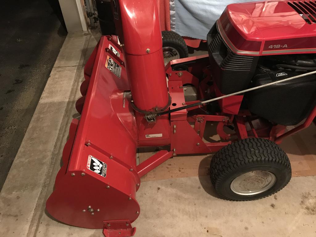

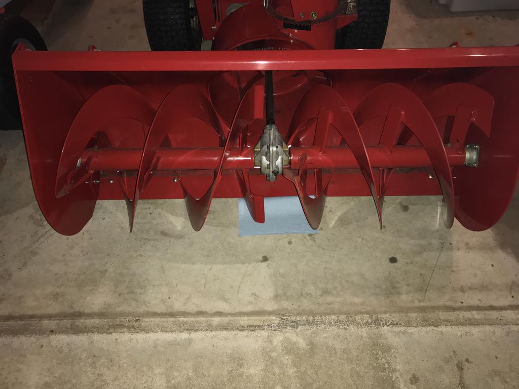

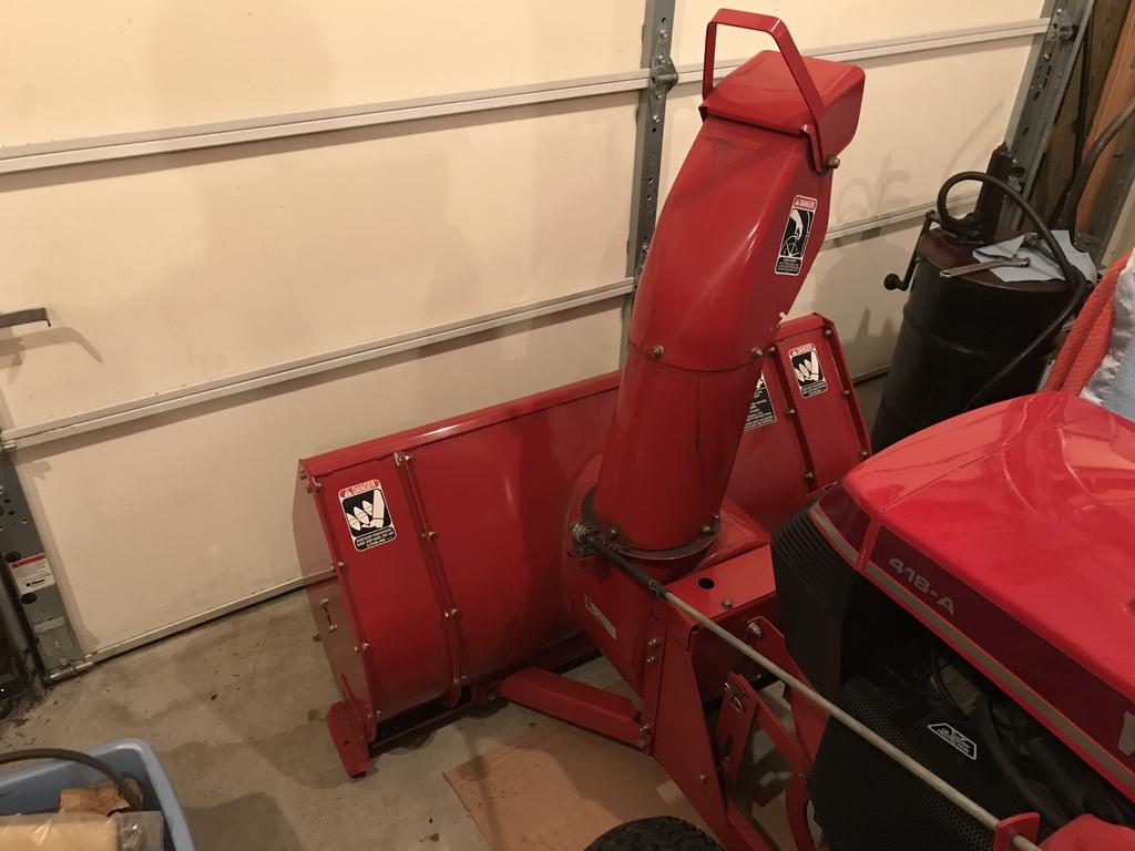

Ike 76 #14 Posted September 10, 2019 Here is the front view. I just picked it up. Thinking I might just try it for a season before I go nuts with it. 2 Share this post Link to post Share on other sites
Ike 76 #15 Posted September 10, 2019 35 minutes ago, WVHillbilly520H said: @wallfish was it you that used the lubriplate grease? Anyways I'm with you on not splitting the gearbox... The only reason I did the impeller was bent from the PO and had sat outside its entire life That does not look like the same blower! Nice restoration! 1 Share this post Link to post Share on other sites
WVHillbilly520H 10,376 #16 Posted September 10, 2019 9 minutes ago, Ike said: Here is the front view. I just picked it up. Thinking I might just try it for a season before I go nuts with it. Looks like the quad rings seals are your leaks... If it were me I would just drain out the remaining oil and add the assembly lube grease, as your blower does look nearly unused. Share this post Link to post Share on other sites
