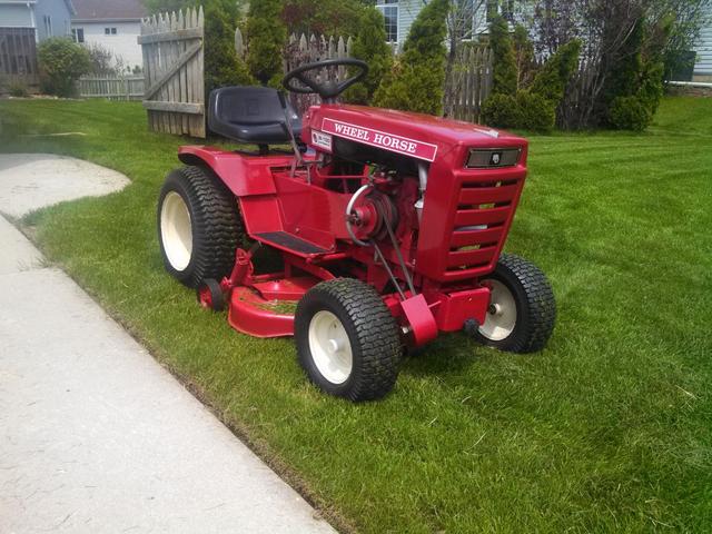

608KEB 812 #1 Posted May 10, 2013 I was mowing the yard and my B-100 wouldn't run unless it was at idle. I limped it into the garage and it quit. I haven't tried to restart it yet. I put a carburetor kit, spark plug and fuel filter on about a month ago. I'm looking for suggestions to get it going again. Share this post Link to post Share on other sites
