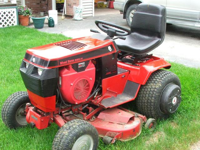

zeedubbya 18 #51 Posted May 16, 2013 That looks great! Was just mowing ( 8 inch grass) today with my 520h and thinking how great it cuts but how concerned I am with the Onan letting go! I'd sure like to have the money and time to do this conversion! Thank you for the detailed information! Share this post Link to post Share on other sites
Forest Road 595 #52 Posted May 16, 2013 Nicely done! I highly recommend Matt's Foot pedal kit. You'll wonder how you mowed without it. Share this post Link to post Share on other sites
Red-Bovine 337 #53 Posted May 16, 2013 I just PM'd Matt for my foot control. I always thought this tractor should have that. We got 22 years out of the Onan. Another twenty would be great. Just couldn't possibly buy a tractor anywhere near this quality for 2 grand. Red 1 Share this post Link to post Share on other sites
Red-Bovine 337 #54 Posted May 17, 2013 Just finished the lawn with the new Honda powered 520H. Very nice. No issues and the engine purred along like it should. I think the economy is better than the Onan, but I didn't have a full tank to start with to be sure. Checked the RPM with a Tiny Tach and it seems to be putting along at about 3700 rpm. Starts like a champ and idles nicely too. Look's like a winner!!! Can't wait to get Matt's Go Pedal system. Red :) Share this post Link to post Share on other sites
leeave96 496 #55 Posted May 17, 2013 Great news! You'll like the foot control too. I guess after the foot control kit, you're next project will be a 2nd tractor, 3rd tractor, 4th tractor... Share this post Link to post Share on other sites

Red-Bovine 337 #57 Posted May 17, 2013 Great news! You'll like the foot control too. I guess after the foot control kit, you're next project will be a 2nd tractor, 3rd tractor, 4th tractor... Thanks!!! One good tractor is enough. Probably more yard work ahead, now, though. Red Share this post Link to post Share on other sites

Red-Bovine 337 #62 Posted December 30, 2013 After nearly a season of mowing (48" deck) and some deep snow removal (44" two stage blower) this winter, I can honestly say this was a good investment and the Honda motor works perfectly with PLENTY of POWER. No problems at all with the Honda GX630. Red 1 Share this post Link to post Share on other sites
leeave96 496 #63 Posted December 30, 2013 After nearly a season of mowing (48" deck) and some deep snow removal (44" two stage blower) this winter, I can honestly say this was a good investment and the Honda motor works perfectly with PLENTY of POWER. No problems at all with the Honda GX630. Red Good news to hear! I think these 520H tractors with the swept forward axle and gear reduction steering are GREAT machines and are a SUPER platform on which to re-power if it becomes necessary. I would imagine the foot control made working your snow thrower much easier! Share this post Link to post Share on other sites
Red-Bovine 337 #64 Posted December 30, 2013 Matt's foot control is AWESOME!!! I love it!! Red Share this post Link to post Share on other sites

LAWRENCE JEWETT 4 #68 Posted December 1, 2014 I know of a member on here that re-powered one of his 520's with a Honda that was supposed to be ready for the 520 conversion. It came from one of the well know en Web site's that promoted the Honda conversion. Short story- it was anything but. He had to do or I should say undo their attempt at wiring, Refab some of PTO stuff. It ended up being a good motor for his 520 and he likes the power. It just not all what the advertised just drop in and go. He talked to the place where purchased it and they were no help at all. Just be careful what your getting into. I also had numerous issues with my Honda GX-670 install. The wiring harness was incorrect and I had to rebuild the clutch bracket. The engine was supposed to be direct bolt-in. Crankshaft bushing on the fan side also caused the engine to seize. Honda would not stand by the engine because they said it was not intended to be installed in an application with horizontal loads. The repower vendor took the engine back and rebuilt it with a thrust washer on the fan side. It has been working great since then and I am happy with it. I have been told that any engine installed in this type of application should have bearings on both sides of the crankshaft. 1 Share this post Link to post Share on other sites
slammer302 2,157 #69 Posted December 1, 2014 I'm surprised to hear the GX-670 doesn't use roller bearings on the crank shaft even most of the Honda knock offs have roller bearings Share this post Link to post Share on other sites
