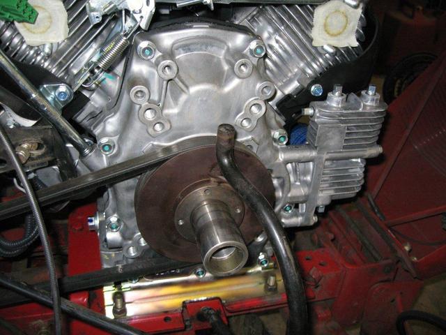

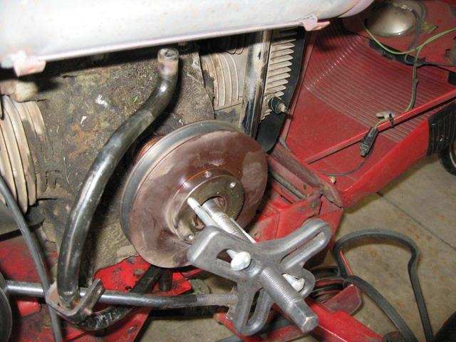

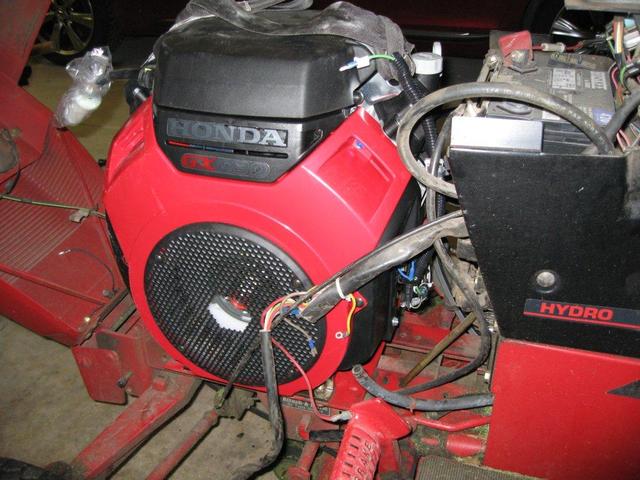

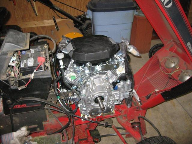

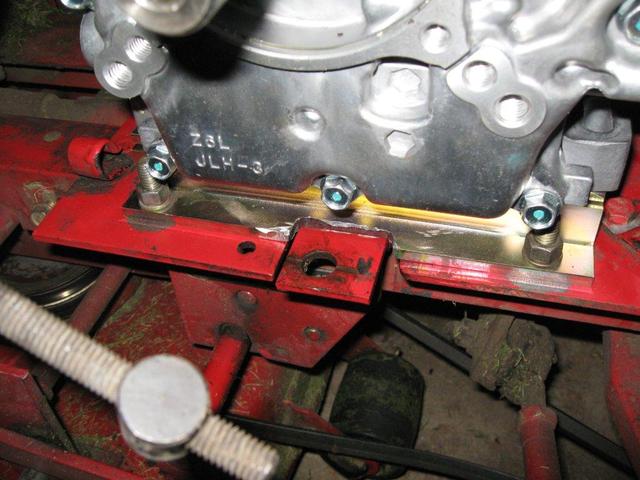

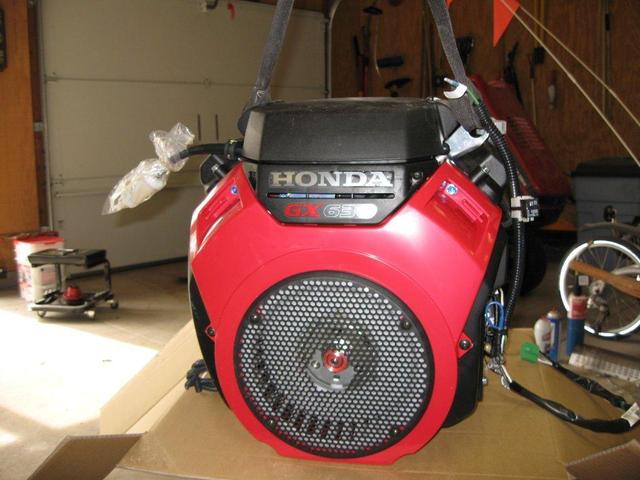

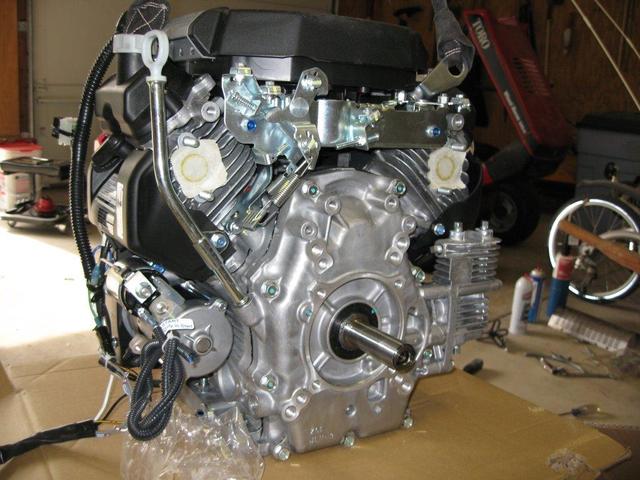

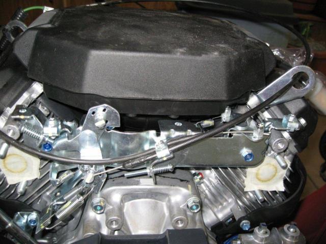

Red-Bovine 334 #33 Posted May 14, 2013 OK !!!! I received the GX630 Honda engine from Repower Specialist in Oregon this afternoon. The unit arrived in perfect condition and included the muffler and parts necessary to mount it into my 520H. There is a new mounting plate that places the shaft correctly for and aft and at the correct height. Slots are provided in the mount for aligning the pulleys. I pulled the old motor off today, mounted the new mounting plate to the tractor and set the new motor on place. I needed to grind a little cutout in the plate to clear the lower PTO clutch mount. The pully was a bit of a bear to remove off the old motor, but a little heat and penetrating oil loosened it up. A bear claw puller worked fine here once heated a bit. Other than that it seems to be a no brainer. I will set the pulleys tomorrow, bolt the motor down, and begin modifying the upper clutch bracket. I need to lengthen the fuel line so I will be replacing the line all the way back to the tank. There doesn't seem to be a temperature probe, a manifold pressure tap fo the power gage, and I'm not sure where the tach is integrated in to the wiring. The motor I received has a fan screen with a hole for a PTO shaft. I'm checking with Repower on rectifing that. I'll post more tomorrow on the clutch mod. Red 1 Share this post Link to post Share on other sites
sorekiwi 761 #34 Posted May 14, 2013 That Honda looks good in there! Share this post Link to post Share on other sites

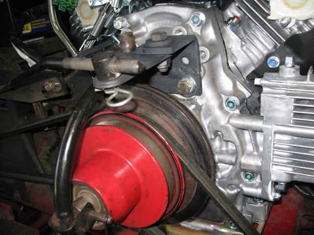

Don1977 604 #36 Posted May 14, 2013 Why are you modifying the upper PTO bracket. Does the top of the loop not line up with the bottom on your tractor. They make a couple of different PTO loops. Mine the top and bottom lined up and I just need a couple of washers behind the bracket. Kelly one of out vendor might have what you need. Tell us what you need it may make the repower easier. This is the one I used came on my C-120. Share this post Link to post Share on other sites

Red-Bovine 334 #38 Posted May 14, 2013 Why are you modifying the upper PTO bracket. Does the top of the loop not line up with the bottom on your tractor. They make a couple of different PTO loops. Mine the top and bottom lined up and I just need a couple of washers behind the bracket. Kelly one of out vendor might have what you need. Tell us what you need it may make the repower easier. This is the one I used came on my C-120. I need to modify the bracket to match the tapped holes in the new motor block and make sure it is at the correct height and make sure the hole in the lever for the upper part of the loop lines up correctly. I think this would be easier than trying to find a different loop. Red Share this post Link to post Share on other sites

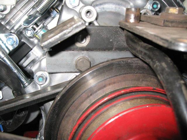

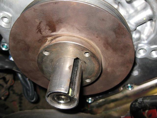

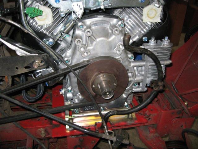

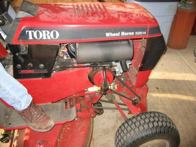

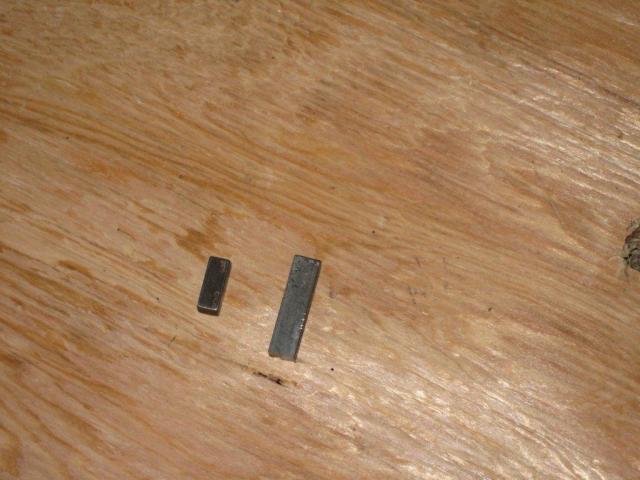

Red-Bovine 334 #39 Posted May 15, 2013 I finished the conversion yesterday and am happy with the results. The motor runs great and the PTO functions perfectly. The first thing I did was to temporarily slide on the main pully and set the motor position to align the pully to the belt. The motor was then bolted down and the belt placed on the pulley. The next picture shows the split collar that converts the shaft from 1" to 1 1/8". A new, thicker, key is provide to compensate for the collar. This needs to be trimmed to the correct size so it does not protrude beyond the bolting collar on the pulley. The next picture shows the key in place and the pulley secured. I made an adapterfor the PTO bracket from 1" X 1/4" bar stock. It was drilled to match holes in the motor block that most closely match the position needed for the PTO upper bracket. Once I was satisfied with the positioning, I welded the bar stock to the bracket. The next picture shows the PTO and linkage attached. The motor adapter plate provided does a good job of setting the correct height of the motor and the correct fore and aft position. Slots in the plate allow you to move the motor in and out to adjust for overall postion. I needed to move the main pulley out 1/4" from the block to properly set the PTO loop to line up with the bottom hole on the frame the PTO loop engages. The choke cable was jogged over from left to right and fasten to the choke. The throttle cable was wrapped around the motor and secured to the motor throttle linkage. I may shorten that cable later to make the connection more direct. The linkage on the motor provides two postions for each cable so you can run them fore or aft, depending on your needs or preference. The next pictures are the completed conversion with venerable hubby trying it out. Wiring was pretty straight forward. The yellow coil wire was attached to the ignition wire on the motor. The light blue wire from the old solenoid was attached to the spade connector on the new starter solenoid. The main red wire and the positive battery cable are attached to the lug on the starter. A new voltage regulator is mounted somewhere convenient on the tractor. I mounted mine on the bracket that hold the front of the main belt guard. There is a loom and plug on the new motor that plugs directly to it. There are two wires that went to the oil pressure switch on the old motor. The dark blue wire goes to the new oil pressure switch. The black wire can be grounded to keep the hour meter running. The white wire that went to the temperature switch is not used unless you care to install a sender on the new motor. The red wire that was plugged into the old voltage regulator is not used nor tis the grey tachometer wire. The only real issure I had with the whole deal was the muffler (does not appear to be a Honda part)) fits the motor just fine, but interferes with the PTO linkage. Lowering the upper bracket is not an option. What I wound up doing was to trim the top of the loop and the bushing and bolt for the lever pivot and making a small dent in the bottom of the muffler so everything would clear. Not a big deal, but annoying. I may look into getting an OEM muffler to see if that makes a difference. I slight smaller diameter would have helped. I still need to adapt the heat shield to the muffler and I want to get an elbow to direct the exhaust away from the belts better. Red 1 Share this post Link to post Share on other sites

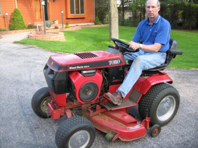

Red-Bovine 334 #40 Posted May 15, 2013 Here are the completed pics of the Honda Wheelhorse. I ran out of space on the last entry. There is a utube link to the video, as well. The squeeking noise in the video is the deck wheels scrubbing on the driveway in the turns. My venerable hubby gets his turn to drive. We don't normally leave the tractor so dusty. I haven't had time to clean it off this spring from the dusty winter projects. http://youtu.be/v2DJ2mWTC44 Red 100% 1 Share this post Link to post Share on other sites

Red-Bovine 334 #42 Posted May 15, 2013 Thank you!! It was easier than I feared. Only took about 12hrs and I am a bit putsy. I also nee to get the PTO hole in the fan screen covered up, yet. No big deal. Red 1 Share this post Link to post Share on other sites
leeave96 490 #43 Posted May 15, 2013 That is an AWESOME job and QUICK too!!!!!! Might I suggest - next up a foot control kit from Matt and a cup holder... Share this post Link to post Share on other sites

Red-Bovine 334 #49 Posted May 15, 2013 When I cut the grass later this week I'll have an idea of the economy of the Honda and how well it performs. So far I am happy with it. I was happy with the Onan until the valve seats started acting up. The Onan was very well built but was also very old technology. That type of valve in block system is just a PITA to work on. I did look at getting an OEM muffler that would fit better and have the heatshield on it. Problem is they are either too high and would necessitate cutting up the hood or they are too low further interfering with the clutch. The mods I made are working fine so I will be leaving that alone and modify the Onan shield to fit the new muffler. Repower Specialists is sending me the flywheel screen that does not have the hole in it for a PTO. As far as the tach, I will verify the RPM and forget that. The manifold pressure Power Gage I will not hook up and the cylinder head temp will not be hooked up either. Everything else seems to be just fine. Red Share this post Link to post Share on other sites
