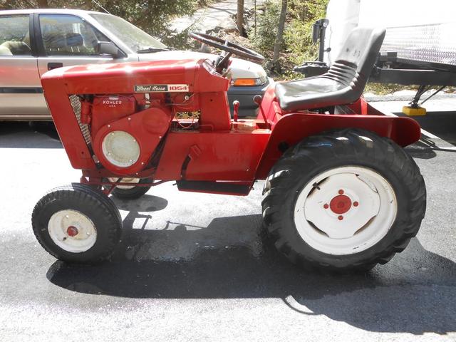

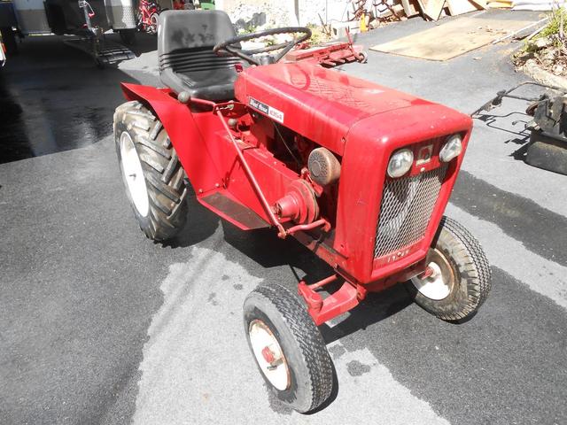

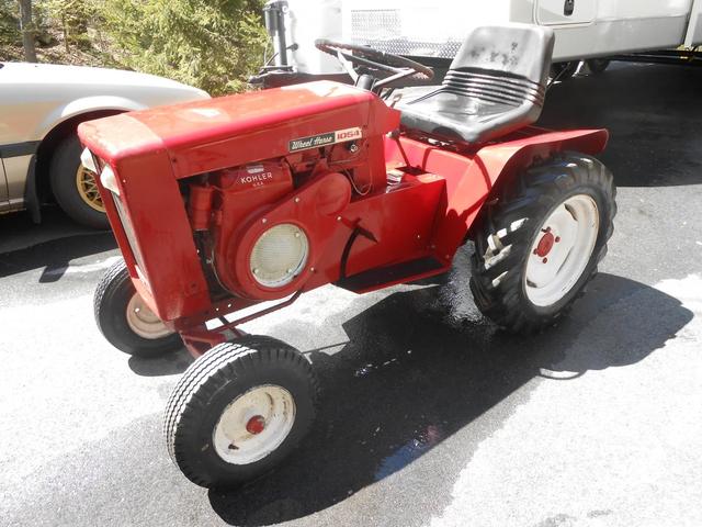

fireman 1,022 #1 Posted May 5, 2013 (edited) Headed out at 6:00am this morning to go pick up the 1054 from Duane. It's a 3 hour ride each way and had to get back in time for dinner with all my family. Also brought home some parts that Docwheelhorse bought from him. The 1054 is great condition. Looks all original except for the seat. Even has a single rear red light on a plate which looks original bought not sure. Gave it a very quick bath as a had to go to dinner with the entire family: Edited May 5, 2013 by fireman 2 Share this post Link to post Share on other sites

stevebo-(Moderator) 8,602 #3 Posted May 5, 2013 A few things that I see wrong with it already..... (tractor police) 1- Rear tires and rims 2- Entire pto set up 3- Front grill I am more than willing to help you find a new home for those itemes Looks very nice for sure! Share this post Link to post Share on other sites
