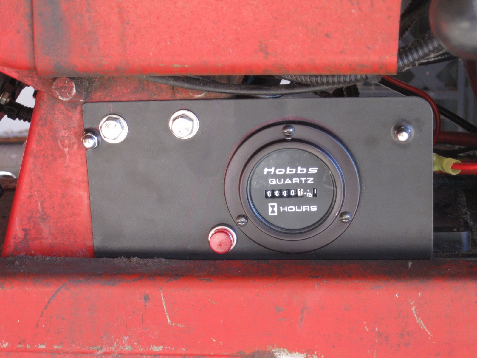

W9JAB 156 #5 Posted May 4, 2013 I had to pull the battery and battery plate, to installed a tee. One side of the tee goes to the drain as seen in the photo, the other side is used for a temperature probe to monitor the oil temperature, as my engine dose not build oil pressure. This makes it a snap to change the oil as I do it every ten hours of running time. Share this post Link to post Share on other sites
