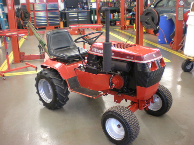

KyBlue 655 #37 Posted September 20, 2014 (edited) Small update... New Fuel Line, Cleaned the area around the Fuel Tank. And put it back together. New Hydro Filter and Drain Plug & fluid. Currently planning to change the filter and Fluid again in the Spring to flush out the remainder of that nasty black liquid that drained out. Still want to strangle the PO!!!! Picture ... I know it stinks... but I'm focused on the Kohler at the moment. Just a reminder, this isn't a restoration at this point ...I'm simply cleaning it up, and making sure she's fit and healthy. Restoration will come in time. For now, She gets to be my primary tractor while I restore my B80 that finally suffered a engine issue (rod knock). Edited September 20, 2014 by 4StarCstms 1 Share this post Link to post Share on other sites

KyBlue 655 #40 Posted September 21, 2014 Bit of progress today, got her cleaned up, Trans filled, brackets bolted down, Ready drop the seat Pan on. Fuel line Routed. Engine Plate in place (need new hardware) Somebody abused the heck out of this poor thing ... Look at what they did to the headlight buckets... ugh! These are supposed to be black right? Layers and Layers of Silver ... 1 Share this post Link to post Share on other sites
Geno 1,930 #41 Posted September 21, 2014 (edited) Supposed to be black. They look good red also. Edited September 21, 2014 by Geno 1 Share this post Link to post Share on other sites
KyBlue 655 #42 Posted September 22, 2014 Not a fan of the red... They'll go back to black... 1 Share this post Link to post Share on other sites
