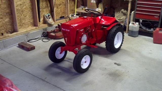

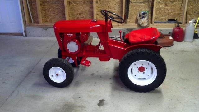

tanner167 6 #1 Posted May 1, 2013 Hello all, new to forum and I have a question On right peddle PTO disengage for mower there is a lever that swivels Which appears to be a lock to keep pto disengaged. How does this work? I can't figure it out for the life of me. Just restored tractor to use solely to take care of my property. It will be a worker in fact just mowed my lawn today with it for first time. What a sweet ride. Here is some tractor porn for yaall. I am also very interested in getting a complete plow setup for it. 3 Share this post Link to post Share on other sites
