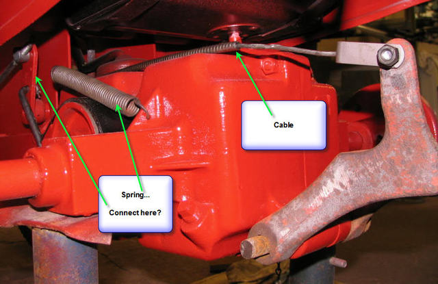

pacer 3,179 #3 Posted May 1, 2013 This is a guess as I only have my 1054 to compare to, but based on that it looks like the brake lining is on upside down - or in this case downside up, and the rod would go in one of the 2 lower holes on the pivot arm - probably the lower one and the spring in the middle??? This pic may show enough to get an idea.... Share this post Link to post Share on other sites

Don1977 605 #7 Posted May 1, 2013 My spring is hooked up where your top hole is don't know if mine has the lower hole. Share this post Link to post Share on other sites
