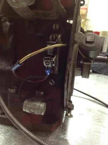

Xjchief 128 #30 Posted May 15, 2013 Is the coil installed correctly? I can't find a single wire diagram. The one in the service manual is kinda vague Share this post Link to post Share on other sites
Jake Kuhn 1,581 #31 Posted May 15, 2013 Do you have a condensor??? Share this post Link to post Share on other sites

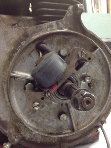

Xjchief 128 #32 Posted May 15, 2013 ,it's not under the flywheel it's next to the points where it was when I got the motor which could b wrong I don't know because after all these parts changed the common denominator is the guy b4 me had to use a drill starting it and I still have to so.. If someone can post a pic of how it should b. (also these 2 pics r b4 I cleaned it all up and replaced things but I put it all back the same way) 2 Share this post Link to post Share on other sites
MarkPalmer 81 #33 Posted May 15, 2013 I can of course be wrong as it's hard to fix an engine over the internet, but I think you are barking up the wrong tree with this being an ignition issue. Your coil and condenser look to be installed in a manner where they should, and do work. If the plug fires strong while pulling the engine cold, ignition probably isn't the trouble. Even running this by some friends of mine, they said if you have a spark that will run the engine warm, and gas enrichment to start it when cold, the trouble is likely elsewhere. One guy mentioned possible weak valve springs to me with your symptoms, so that would be something else to look in to. -Mark- Share this post Link to post Share on other sites

buckrancher 2,695 #37 Posted August 25, 2013 still sounds like a carb issue to me the right condenser for this motor mounts under the flywheel in the half moon cut out on the right side #220082 if you deicide to change it on the back side of the flywheel is a t and s marks for timing if you have a voltage meter you can static time the motor by alining the correct mark in the hole in the alum bearing plate on the side of the motor see the kohler manual for more info Brian Share this post Link to post Share on other sites

Xjchief 128 #41 Posted September 19, 2013 still sounds like a carb issue to me the right condenser for this motor mounts under the flywheel in the half moon cut out on the right side #220082 if you deicide to change it on the back side of the flywheel is a t and s marks for timing if you have a voltage meter you can static time the motor by alining the correct mark in the hole in the alum bearing plate on the side of the motor see the kohler manual for more info Brian This is the next thing I am going to check I am very un clear on timing adjustment on these motors but after checking everything that is the last thing I want to check. How exactly do I check the timing? Share this post Link to post Share on other sites
