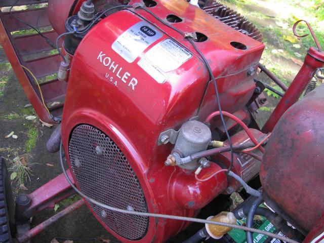

IndianaMatt 34 #1 Posted April 26, 2013 Hey guys Im sort of new to Wheel Horse I have had a 414-8 for a few years and have always mowed with it. I recently ran into a guy that has a nice collection of horses. He is getting older and thinning down the herd. He has a "Black Hood" an older "C" series tractor and several newer 300 and 400 series machines. All the tractors are in good running condition. Many of them have been re-powered with Kohler 16s a few of them are 12s. I am wanting to purchase one and not sure what tractor I want. They are all 8 speeds and there is one Hydro. I was wanting to build a mild pulling tractor that could still be used around the garden. I sort of like the "Black Hood" but its only a 12 horse. Any help would be appreciated in this life changing decision... Matthew Share this post Link to post Share on other sites

Forest Road 595 #7 Posted April 26, 2013 Welcome aboard! The 16hp Kohler is the largest single cylinder you'll find in a WH. The block is different frm the 10,12,&14hp Kohlers. If its a mild puller you wish you won't find a better motor! Good luck! Share this post Link to post Share on other sites

IndianaMatt 34 #11 Posted April 27, 2013 I still have not made a decision other than to buy them both. I have talked with a guy from the local club and they run two different classes one is a 16hp class and the other is a 12hp class. That said anything under 12hp has a class and anything between 12hp and 16hp have another. He said you do not want a 14hp or 10hp. Now about the tractors I am looking at- The guy who built them had upgraded and redone them "his way". He has made them both 8 speed machines and used the larger rear ends? I wasnt aware there was more than one 8 speed rear end? Is this true? The engines on them are not the factory units either. The "C" series tractor has a Kohler Magnum 16 and the "Black Hood" has a Magnum 12 both off new tractors and supposed to have recent overhaul. The "Black Hood" had a set of newer 400 series rear fenders and a much nicer seat with arm rests. The "C" is pretty original on sheet metal but needs paint badly. Thanks Matthew Share this post Link to post Share on other sites
Don1977 605 #12 Posted April 27, 2013 The Black Hood original had a plastic rear fender that is usually broken. It's good that it has been replaced with the metal one. If it has a Magnum 12 the old shaker plate has been removed and the engine is mounted solid to the frame. Share this post Link to post Share on other sites
IndianaMatt 34 #13 Posted April 27, 2013 Don you are correct the engine is mounted directly on the frame. Share this post Link to post Share on other sites
