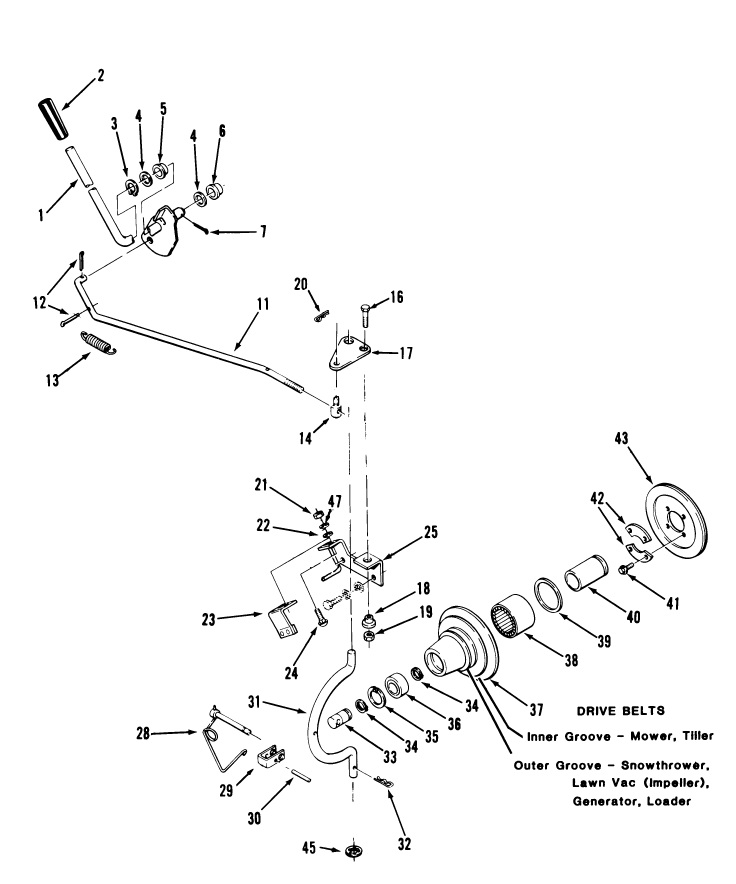

WH854 45 #12 Posted April 24, 2013 (edited) Here you go a picture of your PTO All the parts on your PTO Chas Edited April 25, 2013 by WH854 Share this post Link to post Share on other sites

WH854 45 #16 Posted April 25, 2013 Should not have to remove that roll pin from the hoop just the part # 28 in the picture above! Chas Share this post Link to post Share on other sites
WH nut 553 #17 Posted April 25, 2013 Should not have to remove that roll pin from the hoop just the part # 28 in the picture above! Chas and if you still dont have enough room sometimes removing # 32 helps. thats what I tried posting a picture of Share this post Link to post Share on other sites
TheReDStAnG 4 #18 Posted April 25, 2013 Next time, remove cotter pin (#20) that attaches to the trunion (#14), then pull trunion (#14) out of pto bracket (#17). This will allow you to pull hoop out further. Good luck. BTW get some cotter keys to replace those cotter pins. That makes changeover effortless. Share this post Link to post Share on other sites
WH854 45 #19 Posted April 25, 2013 Take #28 out # 33 swing hoop to left you can take belt off of pulley Chas Share this post Link to post Share on other sites

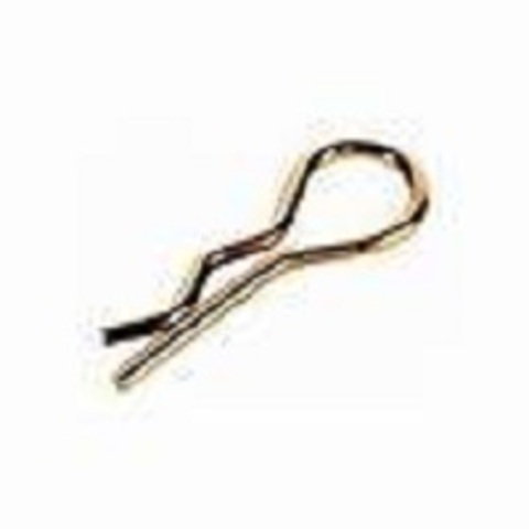

wallfish 18,195 #21 Posted April 26, 2013 Stang nailed it. Remove 2 clips (#20 & #28) and the hoop should swing to the left. No tools required. Share this post Link to post Share on other sites

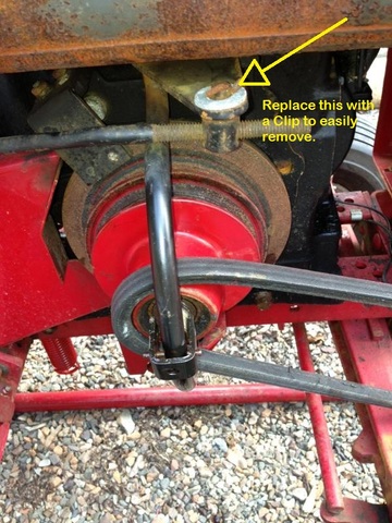

Wyattrrp 59 #22 Posted April 26, 2013 Yes Stang is correct. It takes a few seconds to remove the trunion and the Pin 28 then the hoop can rotate. On my 1981 C125 just removing #28 clip in the parts diagram allows the #31 hoop to swing left to clear the pulley and remove the belt. However newer PTOs, like on my 1990 312-8, after removing #28 clip the hoop wont rotate as you found out, since the #29 bracket hits the shaft. The hoop is too close to the shaft centered in middle of #29 part. You must remove #28 then remove the cotterpin from #14, lift 14 out of the triangular #17 plate and then #17 can rotate moving the hoop #31 out far enough so the #29 clears the pulley shaft moving it left clearing the belt removal. In your 2nd photo, #14 is on the long rod with the threads to adjust PTO tension. You have a bent over cotterpin and grey colored washer that should be removed from your #14, then the threaded rod and #14 will drop down and allow you to rotate #17, moving the hoop #30 outward to clear the clip #29 so you rotate the hoop #30 left clearing the belt area. It will be much easier if you replace that bentover cotter pin with a hitchclip shown in Walllfishes photo, so you dont need to bend a cotter pin back n forth each time. A hitchclip snaps into the cotter hole on the trunion #14 and can easily be pulled out when changing belts or rotating the trunion #14 to adjust the tension on the PTO. Share this post Link to post Share on other sites
WH854 45 #23 Posted April 26, 2013 Well I will try again, on my C-165 and C-105 all I have to do is remove #28 from #29 and #33 #29 drops back to go past #33 to let the hoop #31 swing to the left Wala Works for me Chas Share this post Link to post Share on other sites
Callen 64 #24 Posted April 26, 2013 (edited) Chas, your pic is the older style. My pic is the newer style. 29 wraps so tight on the bail that it can't pivot. Edited April 26, 2013 by Callen Share this post Link to post Share on other sites
