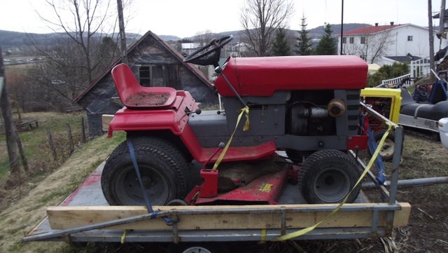

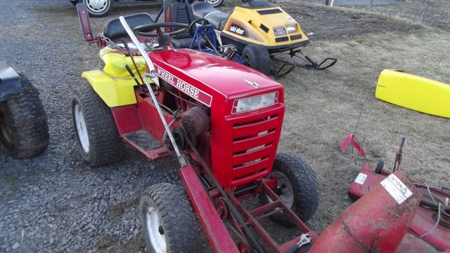

Hatedge 10 #14 Posted April 24, 2013 Ok I know im skipping all the logical steps but I just cant stand the yellow paint on the C160. Since the tractor is going to be a worker I gave the C120 hood a 5.99$ rattle can paint job and installed it on the C160. tomorow ill do the same to the rear fenders and seat. See the ugly yellow hood in the back ground? Share this post Link to post Share on other sites

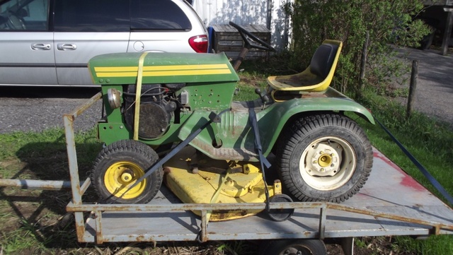

Hatedge 10 #15 Posted May 11, 2013 OK this is a bit off topic but I just picked up 2 more tractors. JD 112 and MF 14 1 Share this post Link to post Share on other sites
