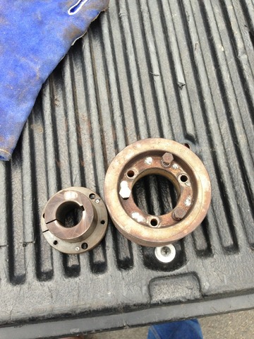

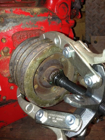

Forest Road 594 #1 Posted April 19, 2013 Does anyone have a clue as to how this comes off? It would appear that there's a cone inside. It was secured by 3 1/4" x 2-1/2 bolts. I believe that the pulley slid over the cone. When the blots were tightened the pulley forced the cone to lick onto the shaft. I have a 3 jaw puller on there. Using an impact gun with low force. Any suggestions would be appreciated! Share this post Link to post Share on other sites
Callen 64 #2 Posted April 19, 2013 Pick at the other three holes. I think you will probably find threads in them. Put the bolts you took out in those holes and it will force the pulley off the cone as you tighten them up. Share this post Link to post Share on other sites
Forest Road 594 #3 Posted April 19, 2013 Won't work. Those 3 bolts went into the cone. They overlap the outside edge of the pulley. Locking the two pieces together. Share this post Link to post Share on other sites
pacer 3,177 #4 Posted April 19, 2013 I agree with Callen - it is designed so that the 3 existing bolts are moved to the other holes and when tightened each a bit at a time the cone will seperate - its a common design. Share this post Link to post Share on other sites
WH854 45 #5 Posted April 19, 2013 That pulley looks like a QD pulley it fits on a steel bushing with set screws as you tighten the screws pulls the pulley tighter on the shaft. you may need some heat to get it to loosen its grip on the shaft Good luck!!! Chas Share this post Link to post Share on other sites

WH854 45 #7 Posted April 19, 2013 Another thought if those screws are used to tighten the pulley on the shaft, using that puller is doing the same thing, if it was me I would take the puller of and give it a big whack with a soft hammer or a piece of wood. Chas Share this post Link to post Share on other sites
CRE1992 143 #8 Posted April 19, 2013 (edited) Is this the engine off the goodall jump start from a service truck on craigslist? If you can, start and run the engine, then use a wire brush on the pulley grooves and look for some set screws. They could be covered in rust or paint. Could be possible there is some set screws in the cone part as well. Also if you get the pulley off in one piece, let me know if you want to sell it instead of getting rid of it or scrapping it, I might be interested price depending. Goodluck! Edited April 19, 2013 by CRE1992 Share this post Link to post Share on other sites
WH nut 553 #9 Posted April 19, 2013 If it is the cone type and you have all the set screws lose, take a hammer and drift and drive the pulley back towards the motor to break it loose Share this post Link to post Share on other sites

SousaKerry 503 #11 Posted April 19, 2013 At first look it appears to be a taper lock bushing but the threaded holes are in the wrong spot for that. Looks like a job for the Hissing Wrench Share this post Link to post Share on other sites
Forest Road 594 #12 Posted April 19, 2013 Callen was spot on ! It didn't just come off. It took a couple shots on the center bushing with an air chisel. Thanks for all your help guys! Share this post Link to post Share on other sites
