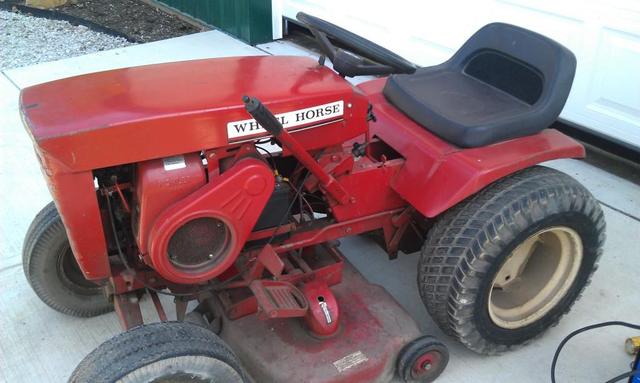

Orezona 0 #1 Posted April 18, 2013 Should the deck on my 655 be set so the wheels lightly touch the ground when mowing? Or should the deck be solidly rolling on the ground when mowing? Thank you in advance, New 655 owner Share this post Link to post Share on other sites
qd-16 15 #2 Posted April 18, 2013 Solidly on ground Share this post Link to post Share on other sites
dsholler 54 #3 Posted April 18, 2013 you want them on the ground so the deck follows the ground contours as closely as possible. If it dangles and you drop one wheel in a hole, it will tilt the deck more than rolling it over the ground. Share this post Link to post Share on other sites
Tankman 3,528 #4 Posted April 19, 2013 Wheels on the deck and you'll need to tow a sweeper! Nice Horse! :smile: Share this post Link to post Share on other sites
