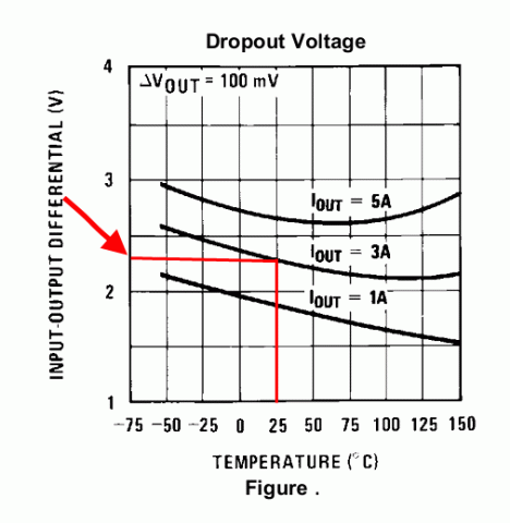

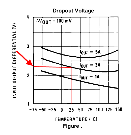

Save Old Iron 1,573 #12 Posted April 18, 2013 Hey Justin, et al Great post. You have received very sound advice so far. Yes, an input filter capacitor is needed for three terminal voltage regulators. A 4700uf 35v might be a good place to start. One of the restrictions on using a three terminal regulator is the need to have the voltage on the input of the regulator at least 3 to 4 volts HIGHER than the needed output voltage. To see if your design is feasible with the the stator you have, borrow a 4700uf (or larger) electrolytic cap rated 35 volts or higher and place it across the output of the current rectifier pc board. Positive (+) capacitor lead goes to the B+ terminal of the rectifier and the negative (-) capacitor lead can go to any chassis ground. Use your multimeter on DC volts to measure the voltage present on the capacitor. If the voltage is higher than 17 volts, the 3 terminal regulators will most likely work. I do believe there are some newer regulator chips that can work with a difference of 1 volt or under from the input to the output. I will have to research that statement a little further but I believe low-differential regs are available. In 5 amps ? - not sure. If you wish to put a small breadboard together for a feasibility test, push the B+ output of the current rectifier board onto the test board, The 4700uf cap will be across the + and - from the rectifier board, then to the LM reg and output of the LM reg can be filtered by a smaller (10 - 100uf) electrolytic cap - then out to the battery. Give it a shot Justin, this is how you learn. Trust me, my pile of failures is way bigger than my pile of successful designs. Never be afraid of failures. Share this post Link to post Share on other sites
Save Old Iron 1,573 #13 Posted April 18, 2013 looks like you will need about 2.2v volts diff from input to output - you will need 16.7 volts on the input cap to the regulator to maintain operation of the regulator under 3 amps of current. That difference increases to about 2.6 volts at 5 amp output from the regulator. Share this post Link to post Share on other sites
