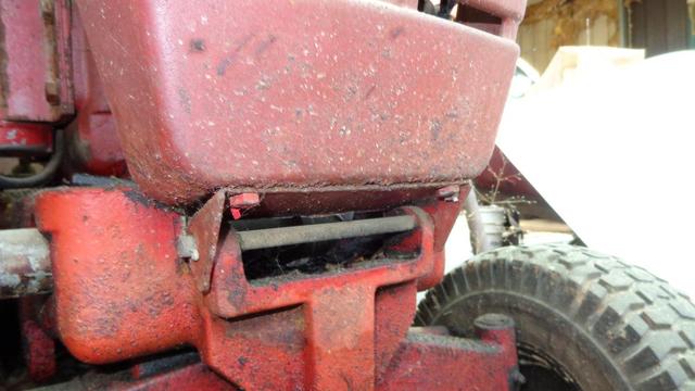

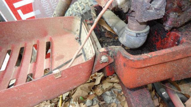

tombones49, these are pictures of my charger v8, my commando v8 is the same, i am pretty sure that the v7 tractors use the same cast iron front frame. Jay

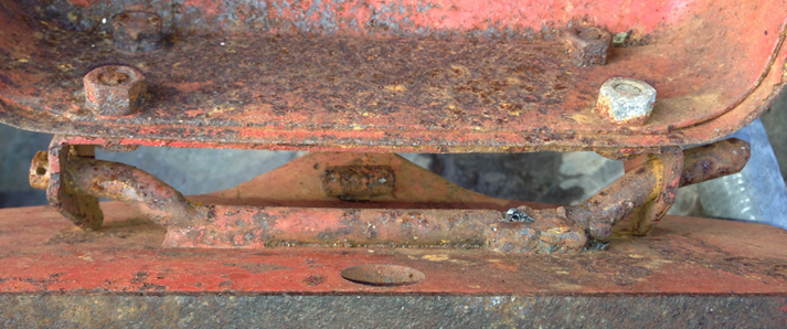

tombones49
They are the same thing only different. The Charger V6 is a better setup than my V7. A whole lot stronger. After taking a couple of
photos, I see where the original mounting bar must have broken on one end, then a piece of cold roll steel bar was "patch welded" in
place of the lost original mounting bar end. The angle of the replacement bar was off, as well as the length of the replacement bar,
so the prior owner bent the hood mounting tang to allow for the poor quality fix. Now that I have taken a close look at what is going on,
I will cut the original bar entirely off then weld a properly formed new bar in place. I will post a photo of the fix prior to finishing the rest
of the restoration.
