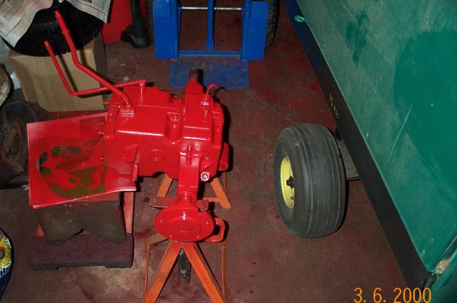

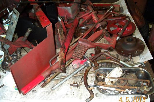

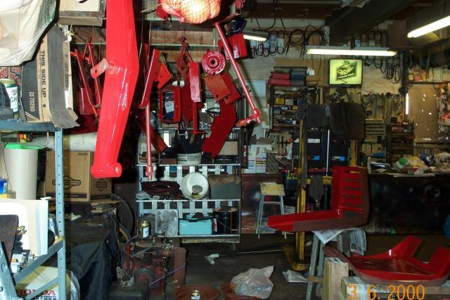

zipper 10 #1 Posted April 11, 2013 Hi all, Joined last month, I personally want to thank everyone that has had a hand in this web site, it's awesome. Took her ALL apart, except the engine and trans which I have redone in the past 5 years Plus I overhauled the cutting deck back in 2002, but had it powder coated gloss black, it didn't cost for the powder coating.. Her numbers are 61-12K802 / 13613/6064, K301s/47421d/7355287 Here's some pic's of the tear down. All the parts are getting sandblasted as I type. Hopefully will get everything back Fri or Sat. Will try to keep up as I get her together. She is a working tractor and I need her ASAP, grass is turning green. zipper attachment=15462:DCP_8946.JPG] Share this post Link to post Share on other sites

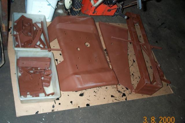

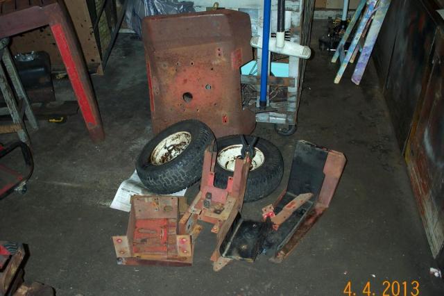

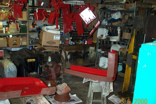

zipper 10 #11 Posted April 12, 2013 Thanks to all the replys and encouragment. Well, its the day after my colonoscopy, feeling much better. Went this morning and picked up all the parts that were sandplasted and primed. Wed. I made a list of all, new hardware I need, since I couldn't go far the crapper. So I'll see what i have and p/u what I need next week. If it warms up next week We will start painting her. Zipper Here's some more pic's. 1 Share this post Link to post Share on other sites

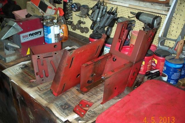

zipper 10 #13 Posted April 26, 2013 Well, finally got the stuff back from my buddy the machinest: front axle - bored out and pressed in bushings for new spindles. (WH did not put bushing in front axle, so I did) lower steering support - bored out for steering shaft and pressed in a bushing (WH did not put bushing for the upper steering shaft, so I did)and replaced bushing for lower steering shaft. front hitch - bored out for axle pin and a steel bushing was made and pressed in. I spot welded the bushing when i got home. now to prime those parts on Fri. Now the BIG ?? to use stainless or zinc coated hardware ??? I have most of the hardware in zinc coated, but would have to buy the ss. Share this post Link to post Share on other sites

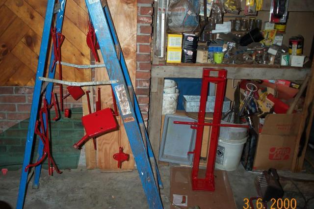

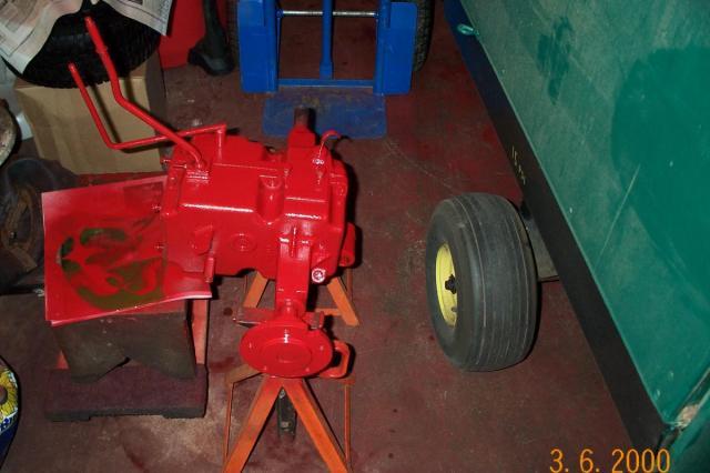

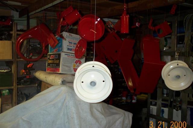

zipper 10 #14 Posted May 1, 2013 Ok, here's some pic's after the first coat of regal red. Thanks for the help of my friend Ron. Share this post Link to post Share on other sites

Don1977 605 #17 Posted May 3, 2013 I noticed your tractor is like my 1977 C-120. There are only 2 holes in the hood stand at the front. My frame had 4 holes 2 at the front and 2 at the back. I drilled 2 more holes in the hood stand as my hood stand had started to crack and I had to weld it. Check your frame and see if it has the back holes. Here is a picture it's the unpainted bolt. There was a hole in the cover plate and a hole in the frame but no hole in the hood stand. Share this post Link to post Share on other sites
zipper 10 #18 Posted May 3, 2013 Don, I'll have yo get back to ya latter, Ma wants to go check out windows at the Harvey showroom. ya know who does the cooking ! Zipper Share this post Link to post Share on other sites
zipper 10 #19 Posted May 4, 2013 Don, On my frame there are 2 holes on the left side and only 1 on the right. As far as the hood stand just the 2 holes toward the front. Thank you for bringing that up, as ours was cracked/broken on both sides just above where the sides attach to the frame with 5/16 x 3/4 bolts, I did weld the pieces up. And when ever I start putting her back together I'll drill the hood stand and frame for the extra bolts. Just finished giving her a second coat of regal red. I will probly give here 4 light coat al together?? Zipper Share this post Link to post Share on other sites

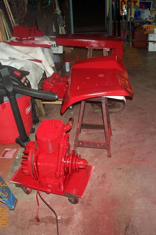

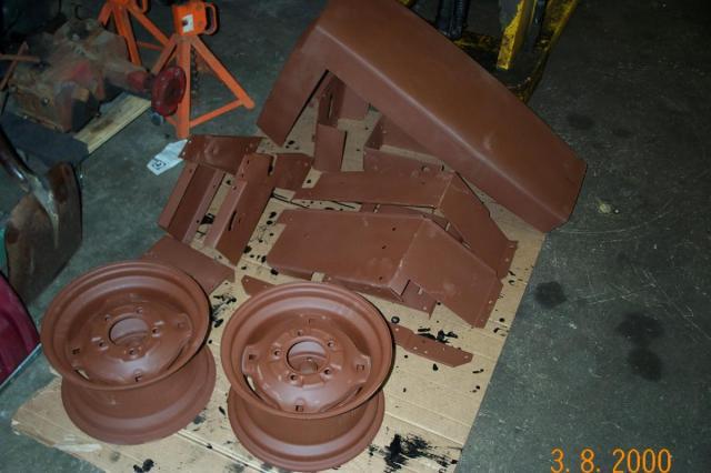

zipper 10 #20 Posted May 17, 2013 finally got a coat on the rims, and engine, top of hood & rear pan, starting to get the itch to bolting her back together, by the way spent a couple of hours down at the hardware store picking up stainless nuts & bolts I know I'll be back there a few more times her's some pic's 1 Share this post Link to post Share on other sites

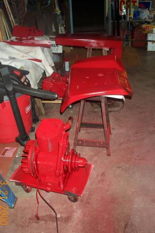

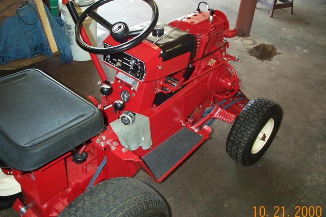

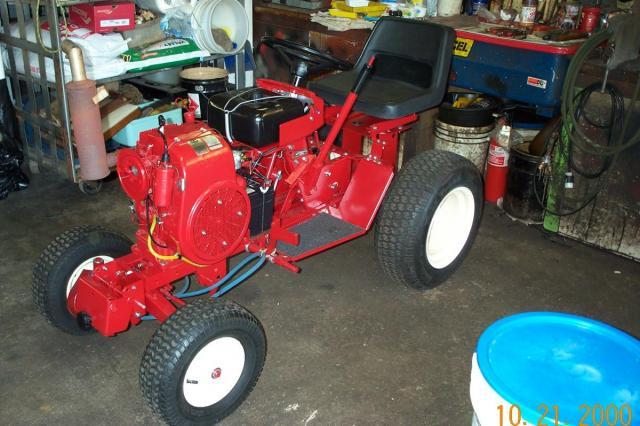

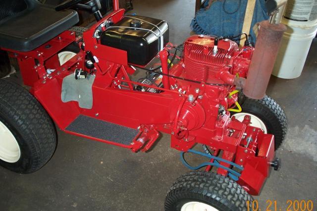

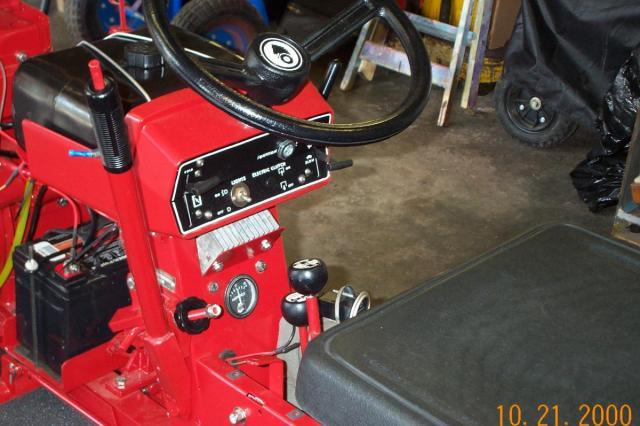

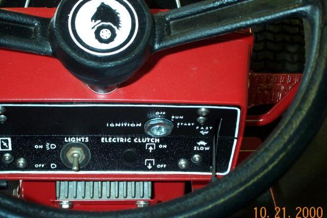

zipper 10 #22 Posted May 23, 2014 I know it's been a year since I started this overhaul/restore/modefided. a lot has happened this past year. One of my best friends, the one that helped me start painting her passed on Feb 14 2014. Then the bride had foot surgury in mid Feb. lost two months doing house work and cooking, now I know why it's the wife's work. Well the old girl is just about done, used her twice to cut the grass, I mean the C-120, not the wife. Here's some pic's, more will follow I forgot to reset the date on camera Thanks for all the help when asked. Zipper 1 Share this post Link to post Share on other sites

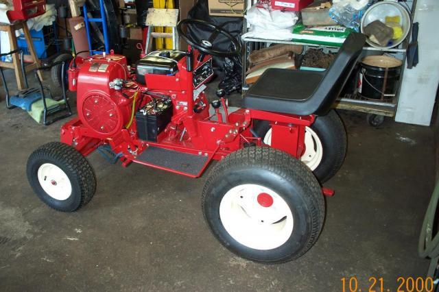

zipper 10 #23 Posted May 23, 2014 here's some more 1 Share this post Link to post Share on other sites

AMC RULES 37,235 #25 Posted May 23, 2014 R.I.P...my condolences on the loss of your good friend... congrats on your stunning resto. Share this post Link to post Share on other sites
