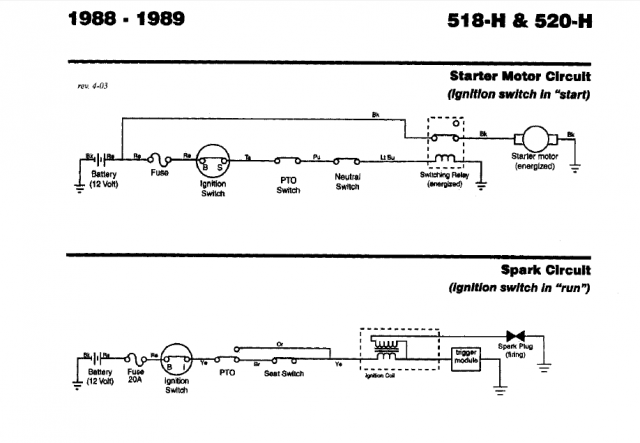

rmaynard 16,201 #6 Posted April 11, 2013 (edited) Here's the wiring diagram for the 518-H. This may help you in your search for the offending gremlin. The PTO switch appears to have two leads coming off of it. One orange and one brown. Looks to me like the orange wire is disconnected at one end or the other. Edited April 11, 2013 by rmaynard Share this post Link to post Share on other sites

WH nut 553 #9 Posted April 14, 2013 Here's the wiring diagram for the 518-H. This may help you in your search for the offending gremlin. 518-H Run.png The PTO switch appears to have two leads coming off of it. One orange and one brown. Looks to me like the orange wire is disconnected at one end or the other. Most Diagrams show the circuit in the rest position but looking at this one it looks like with the PTO engaged which sends the jusice through the seat switch disengaged it goes around it Share this post Link to post Share on other sites
WH nut 553 #10 Posted April 14, 2013 I started to look at my tractor this weekend. Given the responses to this post, I thought that I would replace the seat switch first. Then I realized that, as a new owner of a Wheelhorse, I don't know where to get parts. I can get an original part replacement from Toro or a vendor on Ebay. Here is my question: is this a common part that I could get down at Lowes' or any mower repair store, or does it need to be an original part from Toro/Wheel Horse? Rob Prevost Quick test, jumper Brown to orange at the seat switch and see if it still acts up. Or better yet, jump the 2 wires at the seat switch. It should run whether the PTO is engaged or not Share this post Link to post Share on other sites
