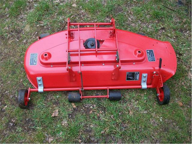

The SD deck was basically in sound shape and just needed getting back to bright metal before painting. OMG aren't there a lot of parts to a deck as I discovered. Came out well though and the decals just make it look right to my mind.

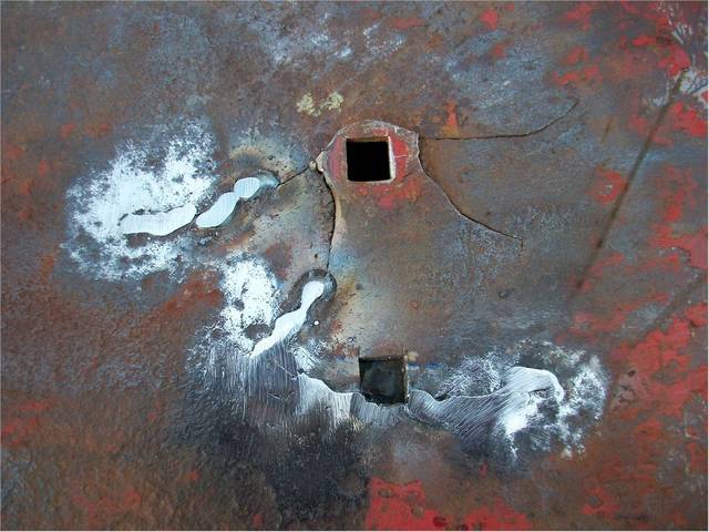

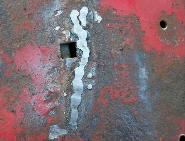

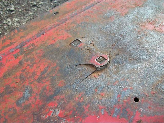

The RD deck was also in sound shape and even still had some of the original paint left underneath though the top had begun to rust badly where it had been left in the rain for a number of years like the 316 it came on. The only real issue was metal fatigue round the hanger mounting points. On one side one pass with the stick did most of the work leaving a couple of hairline fractures to deal with.
post-4509-0-56993800-1365625451_thumb.jp
The other side presented more of a challenge!
post-4509-0-26300700-1365625496_thumb.jp
... and had to be welded a bit at a time working inwards alowing the raised part to be hammered down ready for the next bit and so on.

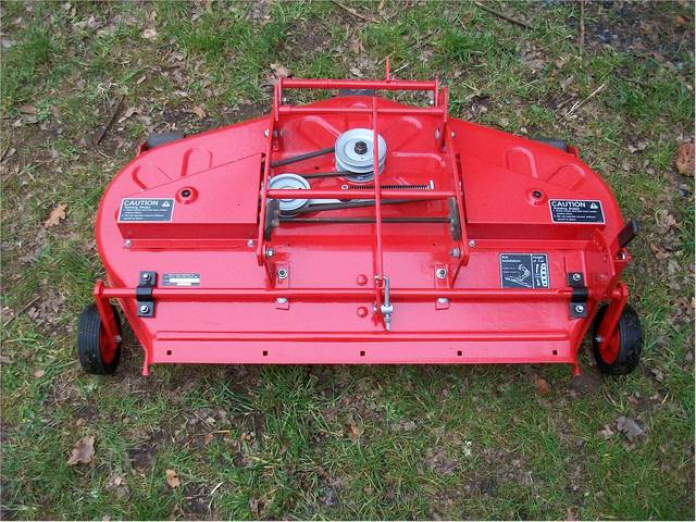

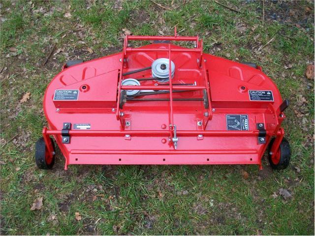

This type of fatigue obviously became a known issue and on a NOS deck I got for the D-200 a reinforcing plate underneath had become factory so I added the same.
post-4509-0-34646300-1365625716_thumb.jp
Came out pretty well and should see rather more seasons now than it would have done otherwise.
The decals have really finished off these decks a treat Mark so thanks for your efforts in creating the ones not already on file, especially the ID tag for the RD - better on the deck than writing the id info down somewhere for future reference and then losing it.
