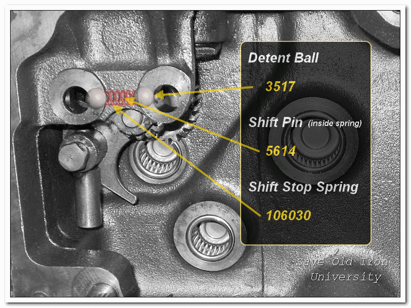

Depending on which shifter fork you are intent on replacing, the speed forks and the HI / LO fork all are operated on the same principal of a captured ball bearing riding in a detented shifter shaft.
The speed shifters are captured by a spring / bar / ball arrangement as seen below.
speedshifterdetentscallout_zpscdabc7d2.g
Part numbers you may need are
http://i1228.photobucket.com/albums/ee458/SOI_University/speedshifterdetentsptnum_zps4234ad24.gif

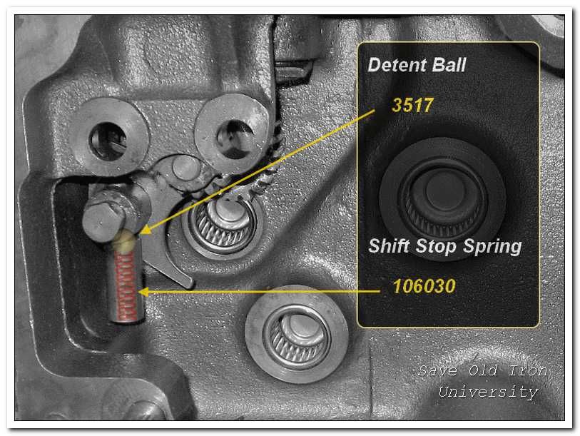

The HI / LO fork is a similar arrangement with the fork retained on a detented bolt ( part numbers the same as for the speed shifters)
http://i1228.photobucket.com/albums/ee458/SOI_University/HILOshifterdetentptnum_tn_zpsacd24e11.jpg
Note - when removing the speed shifter forks, the spring loaded ball bearing detents are under considerable compression. The easiest way I have found of not having the ball bearing and spring fly out of the access hole (blue arrow in the lower left corner of the image below) is to cover the access hole with a strong magnet or place a magnetic retriever in the access hole.
