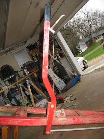

Sparky-(Admin) 23,530 #6 Posted April 7, 2013 A scholar!! Not even close! The angling lever moves back by way of an angle or offset bent into the lever which brings it closer to the operator by 4"+ or -. The lever mounting point on the plow frame doesn't change. Unfortunately my old computer "passed away" this winter and I have lost all my pictures of the kit. I know I posted them on here somewhere, I'll try to find them. Mike................ 1 Share this post Link to post Share on other sites

Sparky-(Admin) 23,530 #10 Posted April 8, 2013 A scholar!! Not even close! The angling lever moves back by way of an angle or offset bent into the lever which brings it closer to the operator by 4"+ or -. The lever mounting point on the plow frame doesn't change. Unfortunately my old computer "passed away" this winter and I have lost all my pictures of the kit. I know I posted them on here somewhere, I'll try to find them. Mike................ I've cut and welded the angle lever in the past using flat bar. Or, my reach is enough perhaps I don't need to modify the lever. The offset in the angle lever is not just to make it more reachable but to keep it away from the PTO bell when its in its most forward position. My extension parts came on a plow I bought used so I don't have a model# for the kit or any of the individual pieces. Mike............. Share this post Link to post Share on other sites

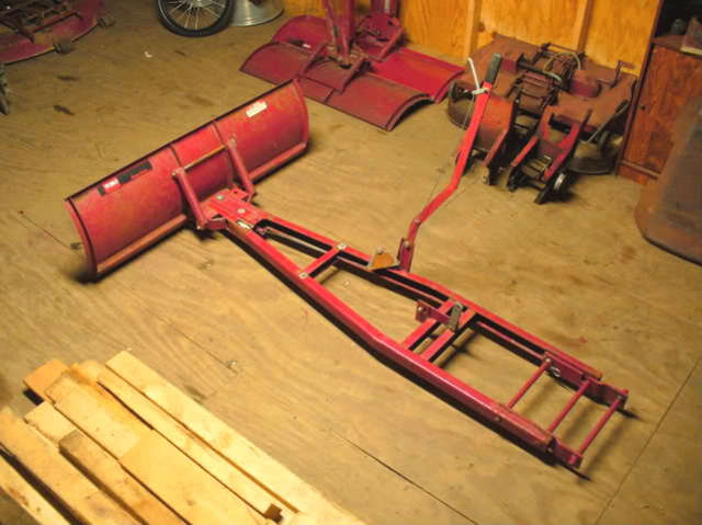

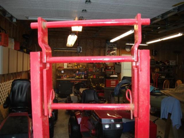

Sparky-(Admin) 23,530 #11 Posted April 8, 2013 Heres a couple pics for reference. Mike........... Share this post Link to post Share on other sites
Tankman 3,523 #12 Posted April 8, 2013 Thanks Mike, pictures say a thousand words. The center lift extension, what is the long bolted arm (or whatever) secured to? PS. Nice looking stallions in the background. Still have 'em? Share this post Link to post Share on other sites

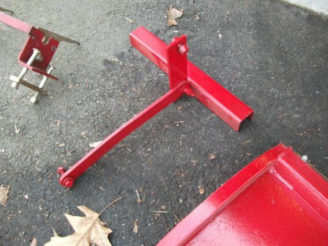

Sparky-(Admin) 23,530 #13 Posted April 9, 2013 The "U" channel piece goes between the plow frame rails behind the original lift point. The short arm bolts into the hole of the original lift point and that is what keeps the part in the proper place. The long arm was my solid lift link. You can see it in this picture I snagged from someone else's post here on Redsquare. Mike............. Share this post Link to post Share on other sites
Tankman 3,523 #14 Posted April 9, 2013 Thanks Sparky. Looks simple enough. Now, if I had some 12ga and a brake I'd be runnin'. I mean plowing. I did read somewhere, shift to the rear is 4-1/2" (?). Seems a bit weak (formed channel for the lift link) but, since I will be welding I'll just locate and weld. I guessing but, as assembled in the pic, would work on my 400's or 520. Different lift link and rear attachment would just stick out the back. Thanks again for the picture. :smile: Share this post Link to post Share on other sites
