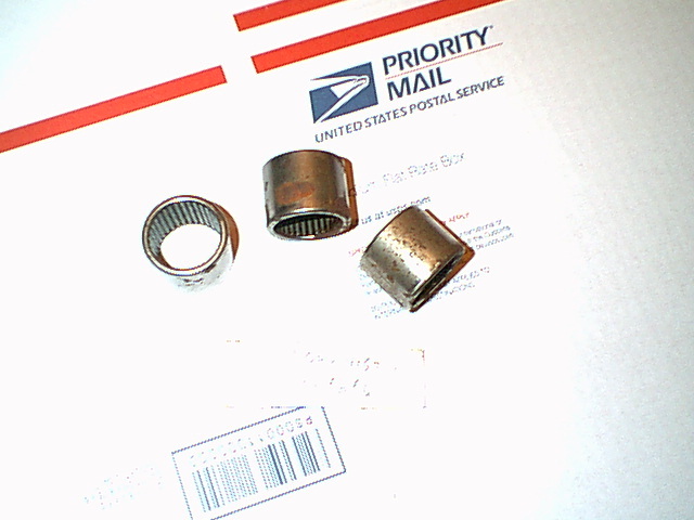

groundhog47 445 #4 Posted April 2, 2013 (edited) The left side needle bearing right behind the axle seal is noisy on my 753. It is possible to replace it without taking apart the transmission? I would like to do it when I replace the axle seals. Believe have some NOS bearings still, PM sent and will verify Wed when get back home, thanks. I was wrong they are 1" axle bearings. Edited April 2, 2013 by groundhog47 Share this post Link to post Share on other sites

groundhog47 445 #6 Posted April 3, 2013 (edited) Ok, I see now they are stamped b1616, so will PM matt... Gerry, he has 1" axles...it is a 5025 transmission. Edited April 3, 2013 by groundhog47 1 Share this post Link to post Share on other sites
