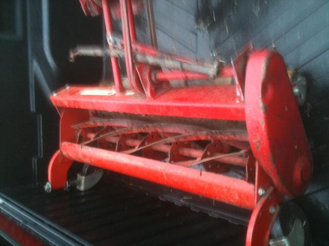

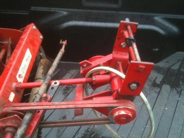

Lane Ranger 11,814 #1 Posted March 30, 2013 (edited) I have a front reel mower which is in very good condition that I bought last year. The mower has a lift bar that was fabricated from steel rod that is not original. I would like to see if one of the Red Square members who has one of these can help me with the dimensions on the # 2520 Lift Bar ( from the LMR-307 front reel mower manual). The one I have will work but I would like to see if I can fabricate a lift bar the was closed to the original design. I started this am to get this ready to mow with and noticed that the gear box for the PTO side drive pulley was upside down. So I am turning that around and filling with gear oil. The lift bar goes in the hole that is suppose to be on the bottom of the gear box -not at the top like in this photo on my reel mower. Any assistance with this would be greatly appreciated. Edited March 30, 2013 by Lane Ranger Share this post Link to post Share on other sites
Lane Ranger 11,814 #2 Posted March 30, 2013 Filled the gear box with gear oil and decided to remove the wooden rollers on the back and paint them black. The clutch bar attachment actually goes on with the gear box facing the tractor -pulley on top. Gear Box and Pulley for PTO to tractor Rear Wooden Rollers -5 for the Wheel Horse LMR-307 Front Reel Mower I just was looking at the front attach-a-matic plate on the B-80 and had a thought that one of these front reel mowers might fit on a B or C model as long as you had the right sized belt to attach to the PTO. Has anyone ever tried this ? Any photos or lessons learned by doing so? Share this post Link to post Share on other sites
