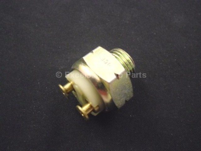

Save Old Iron 1,573 #1 Posted March 26, 2013 If you need replacement safety switches for the clutch pedal or PTO lever on a C Series, replacements are available at the small engine parts supplier for $40+ each or auto parts stores may have what you need on the shelf. Ask for a Backup Reverse Light Switch for a 1979 Jeep CJ5. Cost can be as low as $15 each. I just picked up 2 new ones off eBay for $9 each. Just remember to keep the mounting nut off the old switch. The new switches do not appear to come with the nut. c/o Excelsior Auto Parts - Davenport, Iowa 2 Share this post Link to post Share on other sites

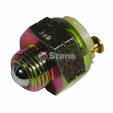

rmaynard 16,843 #3 Posted March 26, 2013 You can also do a search for Stens 430-193, which is a direct replacement for the Wheel Horse safety switch. I have seen them for as little as $18.20, and they have the correct slide-on terminals on the back to fit the existing wiring connector. 2 Share this post Link to post Share on other sites
JimD 3,347 #4 Posted March 27, 2013 Both examples appear to have the correct slide on terminals. It's nice to know they are still available. 1 Share this post Link to post Share on other sites

TDF5G 2,073 #8 Posted October 10, 2016 (edited) The Jeep backup light switch is not a correct replacement. I just bought one. It's a Crown brand part no. J5751207. It's in a normally closed position. The interlock switches on B-C series are normally open. In other words, the Jeep switch operates opposite of the switch. Edited October 10, 2016 by TDF5G Share this post Link to post Share on other sites

doc724 925 #10 Posted October 10, 2016 These switches are indeed normally open. (when you step on the clutch you close them completing the circuit). They are made by Cole Hersee, a division of Stoneridge/Jospeh Pollak Company. Do a search for Pollakaftermarket.com. They do have distributors 1 Share this post Link to post Share on other sites
TDF5G 2,073 #11 Posted October 10, 2016 5 minutes ago, doc724 said: Do a search for Pollakaftermarket.com I did this. They don't have the button terminal open switches listed. They are stud terminal. I've ordered a Stens 430-193/Gravely 020916. Share this post Link to post Share on other sites
TDF5G 2,073 #12 Posted October 14, 2016 I received the Stens 430-193 switch yesterday and it is correct for the B,C series, normally open, interlock switches. Has correct button terminals. Share this post Link to post Share on other sites
