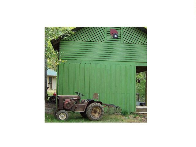

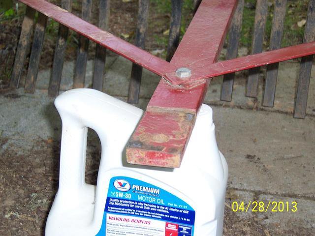

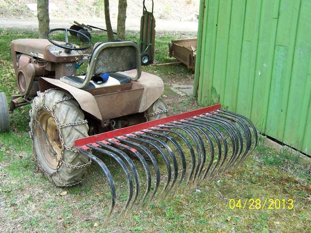

953 nut 69,821 #37 Posted April 27, 2013 Got out in the garden today and took a couple of photos of my home made rake, tines are from Agri Supply. The tong is 2" X 1/2" steel flat stock that I cut down to 3/8 thick to fit the slot hitch. The rest is just 2"angle iron and 1" X 1/8" flat strap. 1 Share this post Link to post Share on other sites
