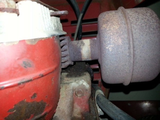

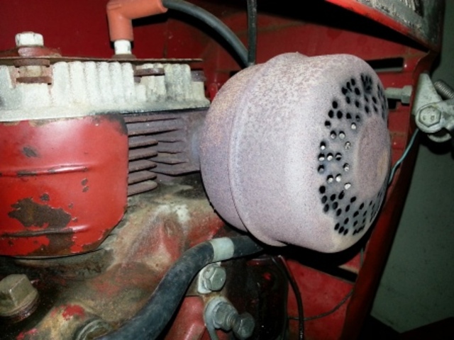

csvt99 173 #4 Posted March 25, 2013 Thanks Martin, I read your post. I'll do some searching and read up on the info that is out there already. Here are some pictures of my current set up. Looks like I will need to: 1. Decide what set up and parts (muffler) I need. 2. Get out the hack saw. 1 Share this post Link to post Share on other sites
pfrederi 18,971 #5 Posted March 25, 2013 This is a cheap replacement muffler used on Cu Cadets and others usually on ebay for less than $30. Quitter than the pepper pot. I do not find stacks to be practical on working tractors what with tree branches and th exhaust being just a bout face height breathing fumes all the time. Share this post Link to post Share on other sites
sorekiwi 761 #6 Posted March 26, 2013 I commented on this recently in an exhaust stack thread. I have this muffler on my Ranger with an 8 hp Kohler I really like it on the small block Kohler, quieter than a pepper pot, but also a lot less harsh sounding. I also have one on a big bock Kohler (12hp) and its still way to noisy on that, but on thhe 8 hp I think its great. 1 Share this post Link to post Share on other sites

csvt99 173 #11 Posted March 26, 2013 I second that! Also will a hardware store have the piece to connect the muffler to the manifold? Will the muffler thread right onto the pipe? 1 Share this post Link to post Share on other sites

sorekiwi 761 #13 Posted March 27, 2013 The side inlet will clamp down on the standard pipe nipple coming out of the block. 1 Share this post Link to post Share on other sites
