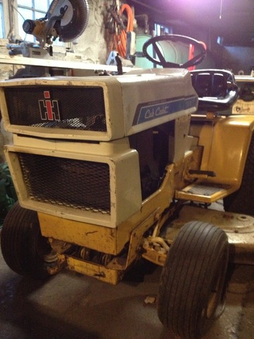

Wh416H 24 #1 Posted March 21, 2013 Good deal on it couldn't pass it up Share this post Link to post Share on other sites

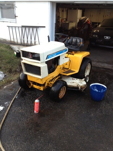

Wh416H 24 #2 Posted March 21, 2013 Put a new battery and solenoid in it and it fire right up Share this post Link to post Share on other sites
Rock farmer 43 #3 Posted March 22, 2013 Put a new battery and solenoid in it and it fire right up You gotta love that! My last.two purchases just needed coils. Nice looking cub! Joe Share this post Link to post Share on other sites

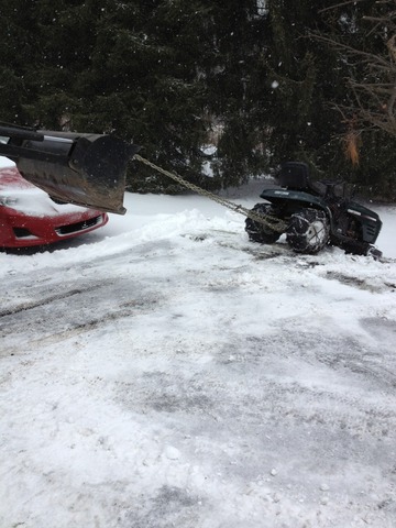

Wh416H 24 #9 Posted March 22, 2013 Won't be the first time I had to pull a tractor out with my wheel horse As u can see Share this post Link to post Share on other sites

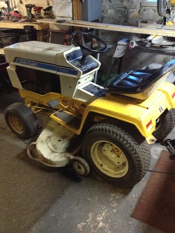

Wh416H 24 #12 Posted March 22, 2013 It's not the good cubs but for free I couldn't pass up Share this post Link to post Share on other sites
Wheel-N-It 2,976 #13 Posted March 23, 2013 It's not the good cubs but for free I couldn't pass up Why do you say its not the good cub??? Its an International Harvester. Not trying to say you don't know what you are talking about. I'm just curious. I like IH Cubs. I have a 1650 with the K-341. What model is it? I can't quite make it out on my computer. I always enjoy seeing some yellow here on Red Square. Share this post Link to post Share on other sites
diesel cowboy 263 #14 Posted March 23, 2013 It's not the good cubs but for free I couldn't pass up Why do you say its not the good cub??? Its an International Harvester. Not trying to say you don't know what you are talking about. I'm just curious. I like IH Cubs. I have a 1650 with the K-341. What model is it? I can't quite make it out on my computer. I always enjoy seeing some yellow here on Red Square. Thats an 1100 cadet. It was the cheap version of the time. 11hp Briggs that they discontinued and no longer make any parts for and a 4 speed peeless trans. The engine is a weird setup, with the carb and air cleaner on the opposite side of the block from the intake valve. It was a decent mowing tractor but when it came to a tiller or snowblower it just wasnt as good as your 1650 or one of the other models with a kohler and the 3 speed or hydro trans. At one point Cub Cadet put out a service buliten for an engine replacement for the 482 which was basicaly the same other than the hoods and side panels. It was for putting in a 14 hp Briggs v-twin from their newer 1440 model and at the bottom of the buliten it said that it should work for the 1100 as well with a couple other modifications. 1 Share this post Link to post Share on other sites

Wh416H 24 #16 Posted March 23, 2013 It's in good shape so I think I'm going to fix it up and use it to cut the grass. It's just another one to add to the collection. I may be going to look at a cub 109 and a wheel horse c125 tomorrow. My wife my kill me if I bring one home so don't know if I'm going or not yet. Share this post Link to post Share on other sites
Wh416H 24 #17 Posted March 23, 2013 So now I don't have to take the loader off my horse to put the mower deck on to cut the grass that's a pain. Share this post Link to post Share on other sites
