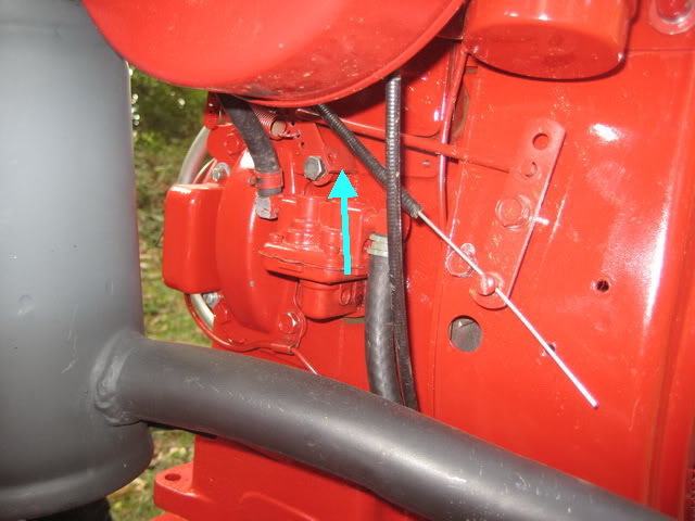

rmaynard 16,836 #7 Posted March 21, 2013 Just a simple question. You said that the linkage all looked correct, but what is the position of the throttle stop? Look at the picture. Is your stop positioned like this? Share this post Link to post Share on other sites
