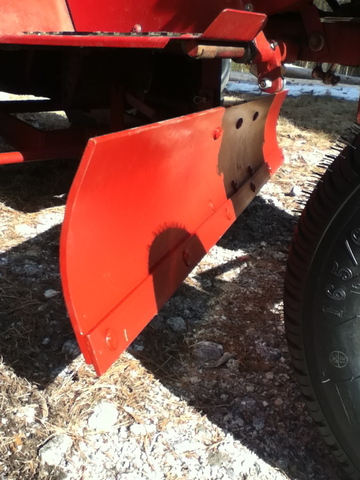

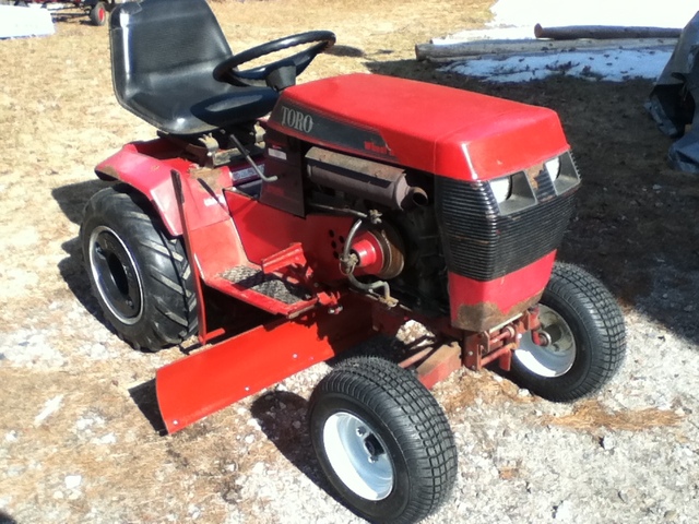

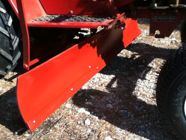

Got the grader blade painted up, and made a replaceable cutting edge for it. I will probably never wear this out, but if I should, I can remove it and flip it over and go some more, saving the edge of the blade.
Got a chance to play with it a little today, taking off a few high spots in the driveway for a trial run. I will wait until the frost is fully gone before I do any more, but sure had fun while it lasted.

Rock farmer
That looks real nice Dave!
Maybe I should paint mine!
I put mine on my 520H today. I had previously used it on my 1276 with a manual lift. That down pressure is impressive! And it will stop the tractor! But I must say I think the manual lift with the height knob adjustment just seemed better. Maybe some sort of turnbuckle to precisely set the height when it's down all the way would be best.
Ideally, I'd like to set the blade edge to a level line between the front and rear wheels when I'm on the machine.
I only ran it briefly. Still some experimenting to be done!

Joe,
I know what you mean about the manual vs hydraulic lift/control.
The down pressure is a little touchy with the hydraulics, but after a while I got the hang of it. (Sort of)  It is just like any other sport requiring hand-eye coordination.  Practice, practice, then more practice.
And after tearing up part of the driveway , I get to practice! :eusa-think:
